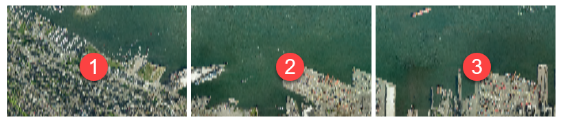

In this example, we start with a set of three individual georeferenced images.
The features are routed into a RasterMosaicker.

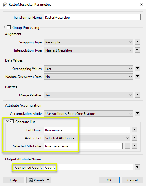

The default settings will provide the desired results. We will also add a Combined Count attribute - Count - to track how many images have gone into the mosaicked image, and create a list attribute called Basenames which will contain the name of each source image.

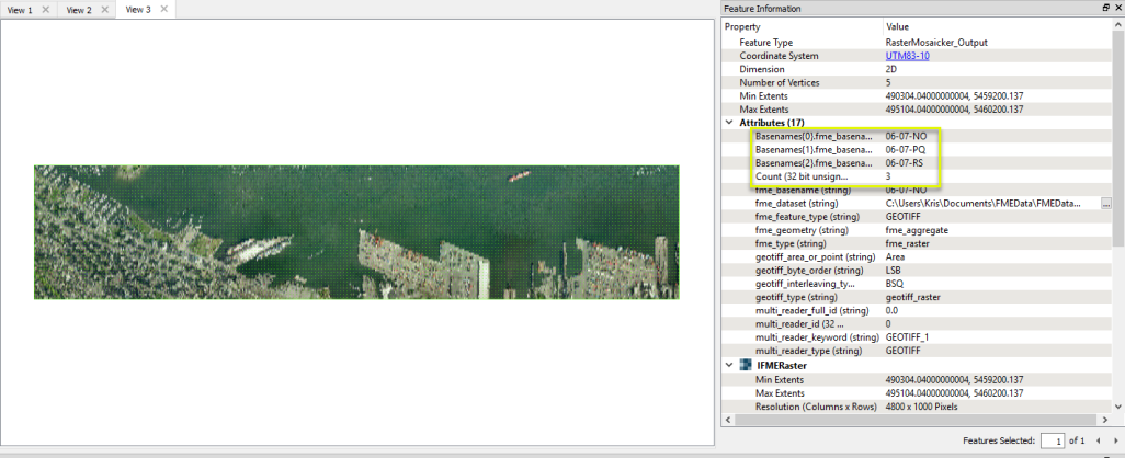

One single raster feature is output. In the FME Data Inspector, we can see the new list attribute and count, indicating that three rasters went into the mosaic, and what their names were.
