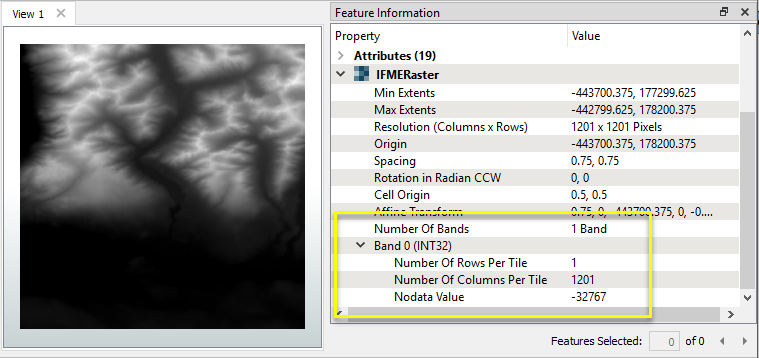

The elevation raster has one band, with the interpretation type INT32 (32-bit integer). The individual cell values in this raster represent elevation in meters.

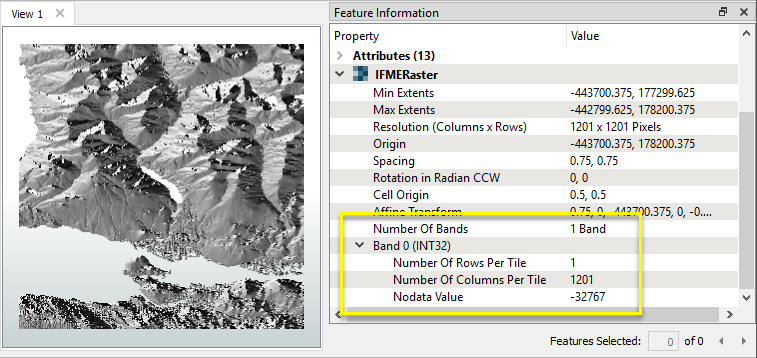

The associated aspect raster also has one band, with values representing the direction, in degrees, that the land faces.

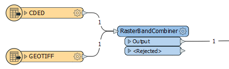

Both raster features are routed into a RasterBandCombiner.

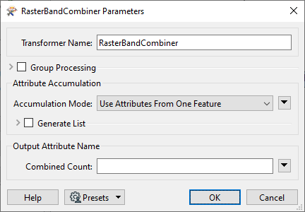

In the parameters dialog, the default settings will produce the desired results.

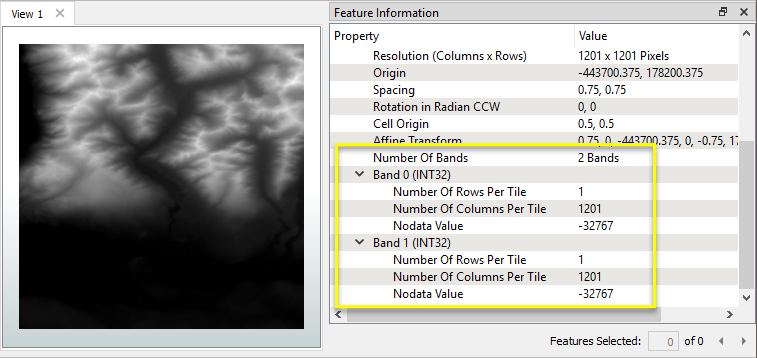

One raster feature is output, with two bands containing the original values from both input features. Note that the raster feature (as viewed in the FME Data Inspector) appears the same as the elevation input raster feature, as it arrived first in the transformer.

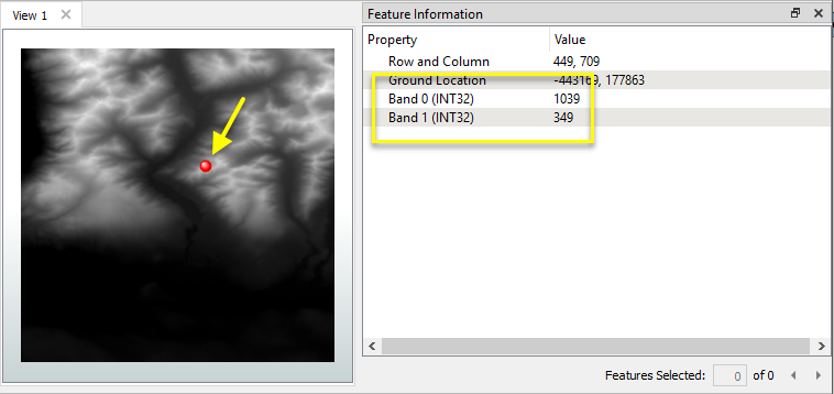

Each cell has two values - elevation integers, and floating-point aspect.
