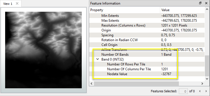

In this example, we will add a band name to a DEM raster. Note that the original raster feature has a single band, with no band name.
The raster is routed into a RasterBandNameSetter. The default state of the raster is “all bands selected,” so this raster’s single band is currently selected and will be acted on by the transformer.

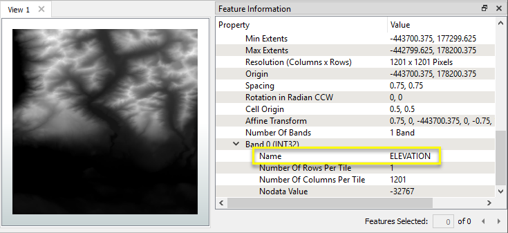

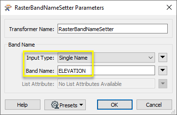

In the parameters dialog, Input Type is set to Single Name, and the Band Name specified is ELEVATION.
The output raster feature now has a band name, ELEVATION.

| Input Type |
Single Name: Set the band name of all selected bands to a specified single band name. List of Names: Set the band names of the selected bands to the names provided in a list attribute. |
| Band Name | If Input Type is Single Name, enter a band name. |
| List Attribute | If Input Type is List of Names, select a list attribute to be used. |
