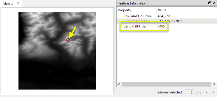

In this example we will perform a slope calculation on a Digital Elevation Model. The source data ranges in elevation from sea level (0) to around 1500 meters, in a mountainous area. Note that elevation is stored in Band 0, as an integer.
Note: This format, CDED, is in an LL83-SECONDS coordinate system - and so the lat/long horizontal (ground) units do not match the vertical (elevation) units in meters.

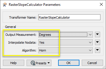

In the parameters dialog, we select an Output Measurement of Degrees, and use the Horn algorithm. Interpolate Nodata is set to Yes.

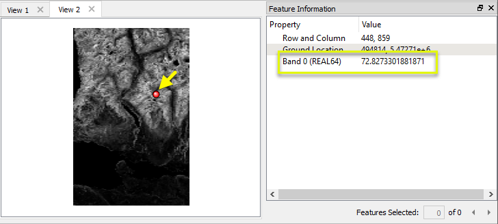

The output raster feature has new Band 0 values - the calculated slope - and the band has been converted to a floating-point decimal interpretation type (real64).
Note the shape of the output raster compared to the original DEM data - a result of the reprojection.
