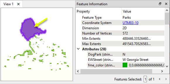

In this example, we have a set of park polygons, and want to scale them down.
The features are routed into a Scaler.

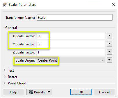

In the parameters dialog, the X and Y Scale Factors are set to 0.5. The Scale Origin chosen is Center Point.

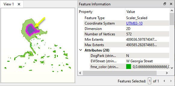

The output features are half the size of the originals, and have been scaled around each feature’s center point.
