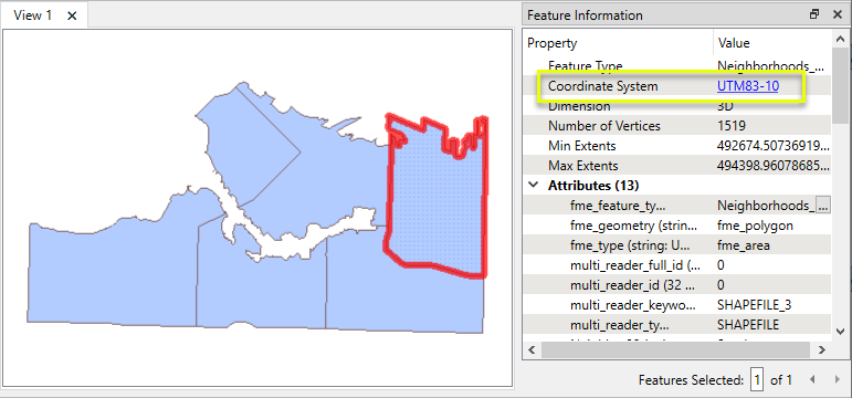

In this example, we will perform various transformations on a set of neighborhood polygon features, which are in a UTM projection with ground units in meters.
The features are routed into an Affiner.

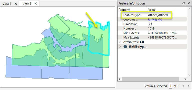

Translating Features East and North

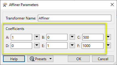

In the parameters dialog, we enter coefficients to move the features 500 meters east and 1000 meters north.
x' = 1x + 0y + 500
y' = 0x + 1y + 1000
The output features have been translated.

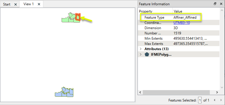

Scaling Features

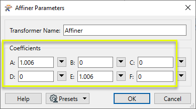

In the parameters dialog, we enter the coefficients to scale the features up by a factor of 1.006.
x' = 1.006x + 0y + 0
y' = 0x + 1.006y + 0
Note that even a small scale factor such as this can produce large shifts in position when the features are georeferenced.

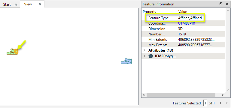

Rotating Features
In the parameters dialog, we enter the coefficients to rotate the features by 0.9 degrees.
We could enter explicit parameter values, but will use expressions to calculate the coefficients.
Note that the math functions @cos() and @sin() expect radians (not degrees), and so we add the @degToRad() function to convert our rotation angle to radians.
x' = cos(0.9)x + -sin(0.9)y + 0
y' = sin(0.9)x + cos(0.9)y + 0
Note that even a small rotation such as this can produce large shifts in position when the features are georeferenced, as they are being rotated about their origin (0,0) which is at a distance.
