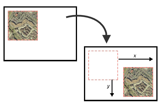

This example shows an image offset using the x and y parameters:
