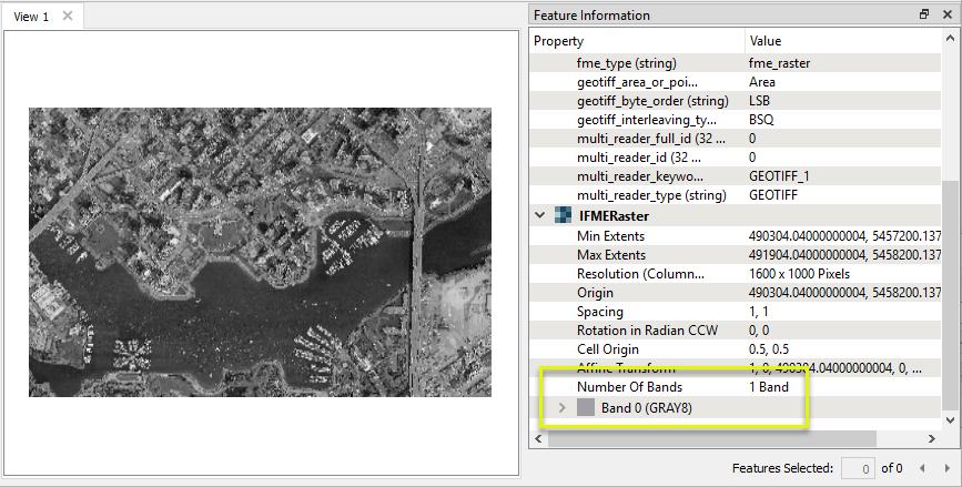

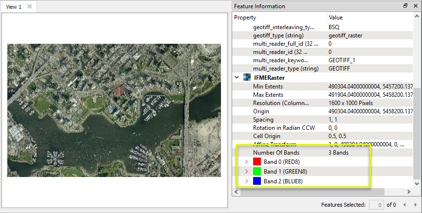

In this example, we will convert a color raster to grayscale. Note that the original raster has three bands - Red, Green and Blue. Values from all bands will be used to calculate a single output value.
The values for each band on each cell will be used for calculations.
The raster is routed into a RasterExpressionEvaluator.
In the parameters dialog, we define a single expression to be calculated and stored in one single Gray band. The Interpretation is set to Gray8, and the Expression references cell values from all three incoming bands. (This formula uses commonly recommended values for color to gray scale conversion.)
Band numbering starts at zero (0), and so A[0] refers to the first band (Red), A[1] refers to the second band (Green), and A[2] refers to the third band (Blue).

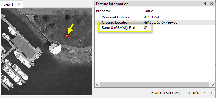

The output raster feature contains only one band, the Gray8 band specified in the parameters.
The results of the expression evaluation are output as cell values.

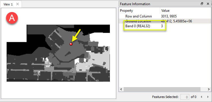

In this example, we will use a RasterExpressionEvaluator to isolate land of a specific zoning type that falls with 150 meters of major arteries.
We start with two numeric rasters. The first represents zoning, with integer values ranging from 1 to 10, where each value arbitrarily represents a zone type. This will be our “A” raster.
We are interested in zone type 3.

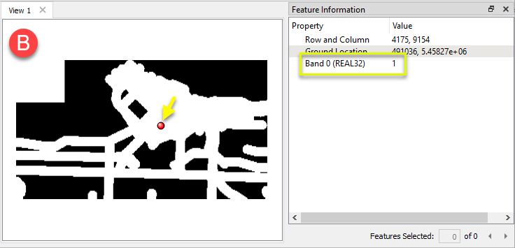

The second raster represents 150 meter buffers along arterial roads. Cells have a value of either 0 or 1, where 1 represents pixels inside the buffer zones, and 0 outside the buffer zones. This is our “B” raster.
The pair of rasters is routed into a RasterExpressionEvaluator - note that Mode: Two Rasters must be selected in the parameters dialog prior to connecting the second raster, to enable (and expose) the B input port.

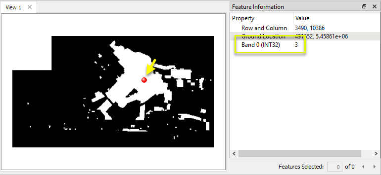

In the parameters dialog, we create a single expression. This will result in a single-band numeric raster being output. An Interpretation type must be specified - Int32 (32-bit integer) is chosen, as an appropriate interpretation type for these values.
The expression references cells from both the A and B rasters, and is using this form:
if (conditions, pass value, fail value)
If the cell value from raster A (zones) is equal to 3, AND the cell value from raster B (artery buffers) is equal to 1, then output the cell value 3. Otherwise, set the cell value to 0.
Note that zero is specified in decimal form as 0.0 (avoiding misinterpretation as Nodata).
Any cells that fall within both zone 3 and an artery buffer are output with a value of 3, and all others cells are 0.
