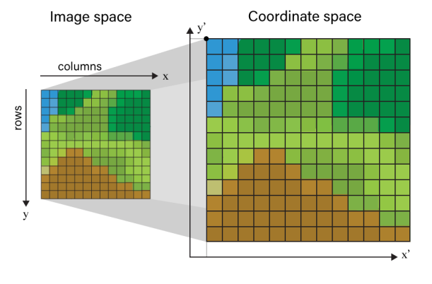

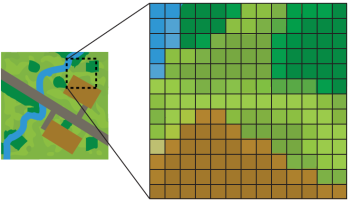

A raster is a rectangular matrix of evenly-spaced cells (sometimes called pixels), arranged in columns and rows.
A raster – and therefore its cells – has one or more bands (sometimes called channels or layers). A band’s interpretation determines what range and type of values it can hold.
Each cell has one numeric value per band.

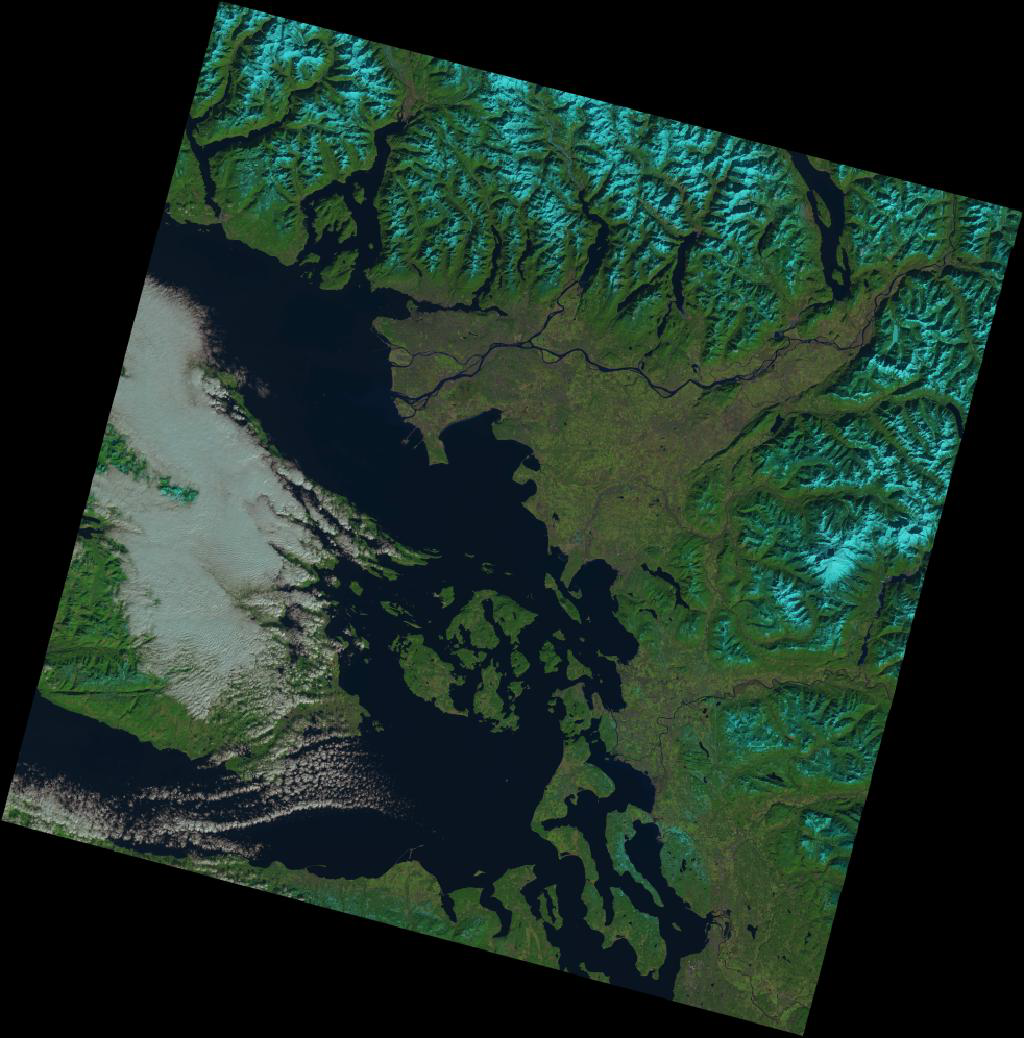

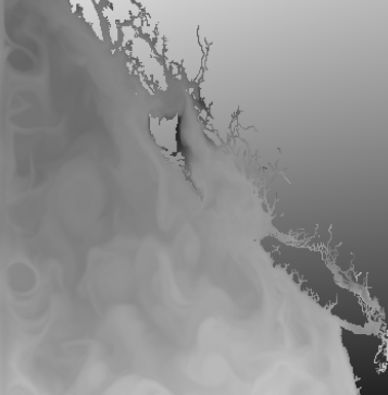

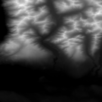

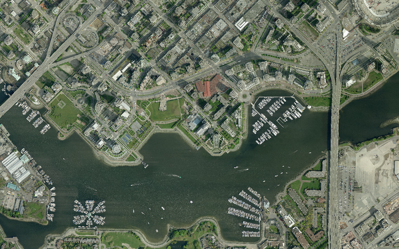

Rasters may represent image or numeric data. Images are commonly derived from satellite data or photography, while numeric data often represents elevations, temperatures, and other quantitative information.
The number of bands will vary – one for a digital elevation model (DEM) or simple numeric raster, three or four for most color image rasters (red, green, blue, and sometimes alpha), and even more for those produced with multiple sensors or representing measurements repeated over time.
| Orthoimage | |
| Photo | |
| Digital Elevation Model | |
| Numeric | |
| Satellite: Multispectral | |

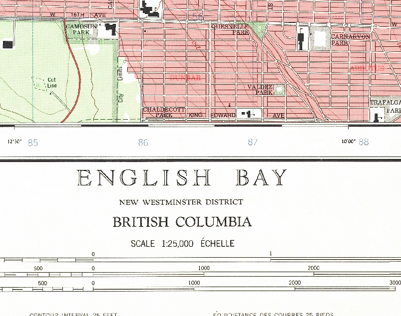

| Scanned map |
Some rasters are georeferenced, and know where they are positioned on the earth. Some, such as scanned maps, can be manually georeferenced. Some may be tied to a point on the earth (as is a photo with embedded GPS information) but the contents of the image are not georeferenced. Some may be associated with a geographic feature and stored as an attribute, common with scanned documents and images.

A raster’s origin with regards to its own columns and rows is the upper left corner.
This differs from its geographical extents, which are described from the lower left to upper right corners. If a raster is georeferenced, these corner x and y coordinates will reflect the units of the raster’s coordinate system (meters or degrees, for example).

Raster Property |
Description |
Sample Values (Orthophoto) |
| Minimum Extents |
X and y coordinates, in ground units, of the lower left corner of the raster. |
488704, 5461200
| Maximum Extents |
X and y coordinates, in ground units, of the upper right corner of the raster. |
490304, 5462200
| Resolution (Columns x Rows) |
Total number of columns (x-axis) and rows (y-axis). |
1600 x 1000 Pixels
| Origin |
X and y coordinates, in ground units, of the upper left corner of the raster. |
488704, 5462200
| Spacing |
Fixed distance in the x and y dimensions between each cell in the raster. Some formats store only one spacing value, requiring square cells. Also known as cell size. For georeferenced rasters, spacing is in ground units. |
1,1
Rotation in Radian CCW |
Represents the rotation of a raster relative to the x and y axes. 0,0 means no rotation – the raster is aligned straight along both axes. Rotation is measured in radians, counter-clockwise:
Unequal x and y rotation values will produce a shear. The rotation point is the raster origin (upper left corner). |
Cell Origin |
The reference point of a cell, that is, the point within each cell from which the pixel for that cell is derived. The lower left corner of the cell in the x or y dimension is The FME default is |
Affine Transform |
Origin, Spacing, and Rotation form an affine transformation. |
1, 0, 488704, 0, -1, 5462200
Coefficients in the affine transformation:
A = 1
B = 0
C = 488704.04000000004
D = 0
E = -1
F = 5462200.137
or
x' = 1x + 0y + 488704.04000000004y' = 0x - 1y + 5462200.137

Ground Control Points (GCPs) are sometimes used to georeference rasters. If they exist on a raster, they will appear as a raster property.
Each GCP is a pair of locations, matching a cell (column, row) in the raster to a point in a coordinate system (x,y,z). A minimum of three GCPs are needed for georeferencing.
Raster Property |
Description |
Sample Values (Scanned Topographic Map) |
| GCP Coordinate System |
The coordinate system of the referenced points (not necessarily the same coordinate system as the raster). |
UTM27-10
| Ground Control Points |
A series of numbered GCPs, starting with zero (0), each consisting of a cell position (column, row) matched to a real-world position (x,y,z) in the designated GCP Coordinate System. |
0: 6863, 1442, 483000, 5456000, 0
1: 1143, 1415, 483000, 5468000, 0
2: 1120, 4754, 490000, 5468000, 0
GCPs can either be applied to the raster, resulting in the image being georeferenced and tagged with the GCP Coordinate System, or the GCPs can be extracted and stored on the resulting data file for those formats supporting unreferenced data and GCP storage.

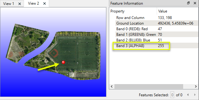

Alpha bands are often used with RGB rasters, forming RGBA. The alpha value indicates transparency, where zero (0) is fully transparent and the maximum value (255 if 8-bit) is fully opaque. This affects the display of the other bands, and is often used to create transparency where no data exists, as in irregularly shaped or rotated rasters which might otherwise have areas displayed as black pixels.

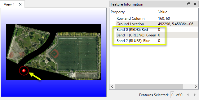

In this example, an irregularly-shaped raster is produced by clipping to a park boundary. Cells that fall outside the park boundary but inside the raster's rectangular extents are black.
By adding an Alpha band with the value zero (0) in locations that have no data, they are rendered as transparent.
Note that pixels in the Alpha band in locations where there is data – that is, color – have a value of 255, which is fully opaque.

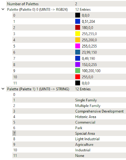

The palette consists of a series of pairs of palette keys and palette values. The palette key is matched to the band’s cell values, and must have the same interpretation type as the band. Bands must be a UInt8, UInt16, or UInt32 interpretation type to have palettes. Palette keys of UInt64 are not supported.
Palette values can be RGB24, RGBA32, RGB48, RGBA64, Gray8, Gray16, or String, as in this example:
