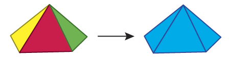

The example below illustrates a geometric feature of diverse attributes on the left and its aggregated output on the right.

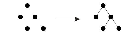

The example below illustrates a set of points representing a non-aggregated data structure on the left and its corresponding aggregated output on the right.
