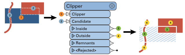

The Clipper works on all geometry types. This diagram illustrates area-on-line and area-on-area vector clipping results.
- (1) is a single area Clipper (in blue).
- (2) are the Candidates, a red line that crosses the Clipper (1), and red area that partially overlays the Clipper (1).
Both the line and area Candidates are split where they cross the Clipper boundary, and the results are output:
- (3) Portions of Candidates that fall Inside the Clipper (red only)
- (4) Portions of Candidates that fall Outside the Clipper (red only)

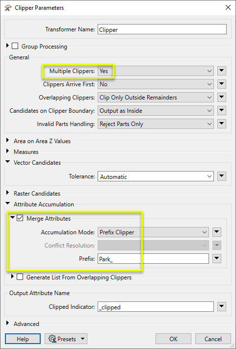

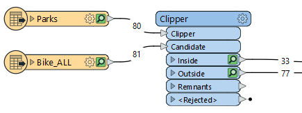

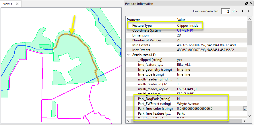

In this example, we start with two datasets - one with multiple park polygons, and the second with bike path lines. The bike paths run in and out of multiple parks, as can be seen here with the path selected and highlighted in yellow.
In the workspace, the parks are routed into the Clipper input port, and the bike paths are the Candidates - the features that will be altered according to the Clippers.
In the Clipper parameters dialog, Multiple Clippers is set to Yes, as we have multiple park polygons and want to clip the paths with all of them.
We enable Merge Attributes, which will transfer attributes from the parks (Clippers) to the lines (Candidates). By choosing Prefix Clipper, these new attributes will be prefixed with our string “Park_” and clearly indicate the source of the attribute.

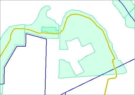

The bike paths are split where they encounter a park boundary, receive attributes prefixed with Park_, and are output as either Inside or Outside feature types (shown here in blue and magenta).

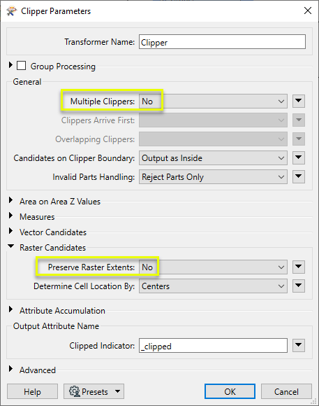

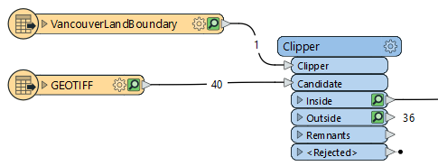

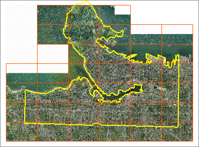

In this example, we have a series of orthophoto tiles, which we would like to clip to the city’s land boundary. The boundaries (extents) of each raster are overlaid in orange.
The boundary - a single polygon - is connected to the Clipper input port, and the series of TIFF images are connected to the Candidate port.
In the Clipper parameters dialog, Multiple Clippers is set to No, which will improve performance in this case, where we do have a single Clipper area.
For a raster clipping operation, the only other parameters we need to look at are Raster Candidates, where we choose whether or not we want areas outside the clip boundary to be padded with Nodata pixels to their original extents. No is the default, and fine for this case. (If you want the output rasters to retain their original dimensions, you would choose Yes.)

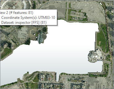

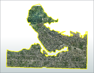

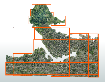

Of the 40 rasters that went in, 32 of them fell partially or entirely Inside the clip boundary. In the rasters that intersected the boundary, cells that fall inside are untouched. Cells that fall outside have all bands set to 0, and an alpha channel added (also 0), making those areas transparent.
This close-up shows the clipping of pixels along the water boundary.
The extents of new rasters are shown here in orange. They are of varying size now, clipped tightly to the Clipper boundary (as we chose not to Preserve Raster Extents).

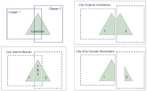

Controls how candidates get clipped when there are multiple clippers that overlap each other.
Clip Interim Results: Each clipper feature will clip the interim results (both inside and outside) produced by the previous clipper feature’s interaction with all the candidates. The part of a candidate that’s outside of all clippers will be output from the outside port. This option allows for each output piece to acquire the attributes from each of the Clipper features they were clipped by. Clip Original Candidates: Each clipper feature will clip the original form of a candidate. Their intersection will be output via the inside port. The part of a candidate that’s outside of all clippers will be output from the outside port. Clip Only Outside Remainders: Each candidate will be clipped by the first clipper, then the part that’s outside of the first clipper will be clipped by the second clipper, and so on. The part of a candidate that’s outside of all clippers will be output from the outside port. Note: Because Clippers are applied to Candidates in the same order that they arrive at the factory, ordering Clippers by their likelihood to contain candidates may improve performance. |
