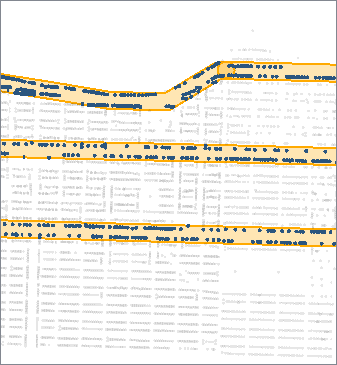

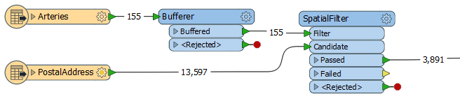

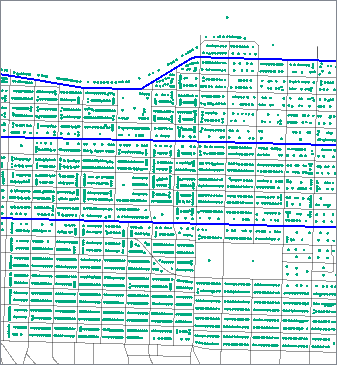

In this example, we buffer arterial streets (shown in blue) to find address points that fall within a fixed distance of them. The streets data is in a UTM coordinate system, with ground units in meters.
The arteries are routed into a Bufferer.

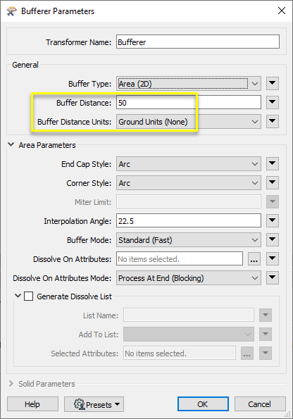

We enter a Buffer Distance of 50, and leave the Buffer Distance Units as the default setting Ground Units (None). This will produce buffers of 50 meters to either side of the street.
The Buffer Type is the default, Area (2D) .
The buffered streets are then sent to a SpatialFilter, along with the address points, and are tested for points that fall within the buffers.

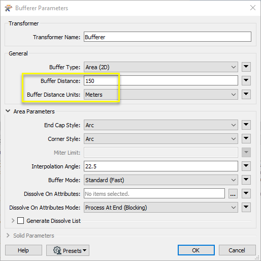

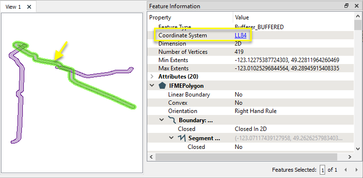

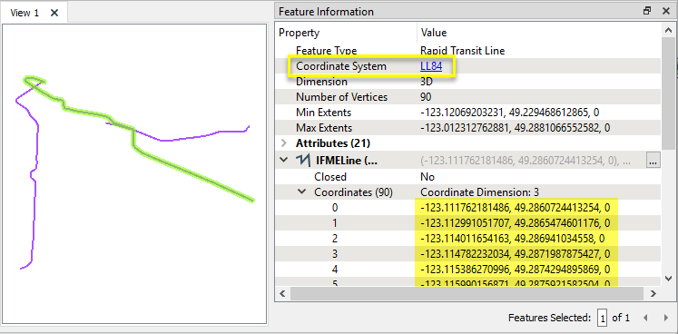

In this example, we create buffer zones around rapid transit lines. The source data is KML, in a geographic lat/long projection.
As the ground units are in degrees, the data must be reprojected before making calculations in units like meters or feet. The Buffer Distance Units parameter will take care of that.
The lines are routed into a Bufferer.
In the parameters dialog, we select Meters as our ground unit of choice, and set a Buffer Distance of 150.
The resulting Output buffer polygons retain the attributes of the original features, and are projected in the original lat/long coordinate system.

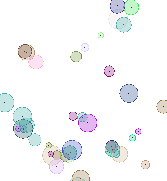

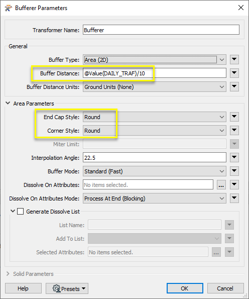

In this example, we take a point dataset of food carts that has an attribute containing the average number of daily customers they serve. We route the points into the Bufferer.
A bit of experimentation shows that dividing the daily traffic numbers by 10 will produce a desirable range of bubble sizes, and so we set the Buffer Distance to the value of the DAILY_TRAF attribute, divided by 10.
The resulting buffers are colored according to the category of food cart (type of food served).
