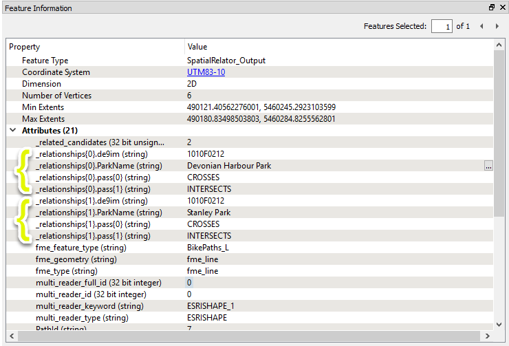

Output for a feature that matches two Suppliers might look like this, using default attribute names and selecting a single Supplier attribute for inclusion:

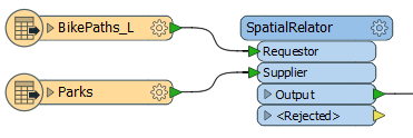

In this example, we compare a set of line features (bike paths) with polygons representing city parks. The bike paths are the Requestor - the features we want information about - and the parks are the Supplier that they will be compared to. Only bike paths with added attributes will be output - the parks will be discarded after they have been used to perform the spatial analysis.

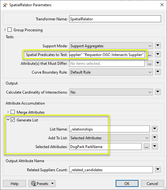

In the SpatialRelator parameters dialog, we make the following selections:

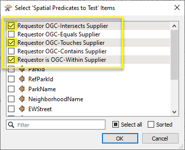

- Spatial Predicates to Test: for this case, we will select the spatial relationships we are interested in:
Generate List: generating a list is the default choice, and supports adding attributes for multiple matches. Under Add to List, we choose Selected Attributes, and then select DogPark and ParkName:

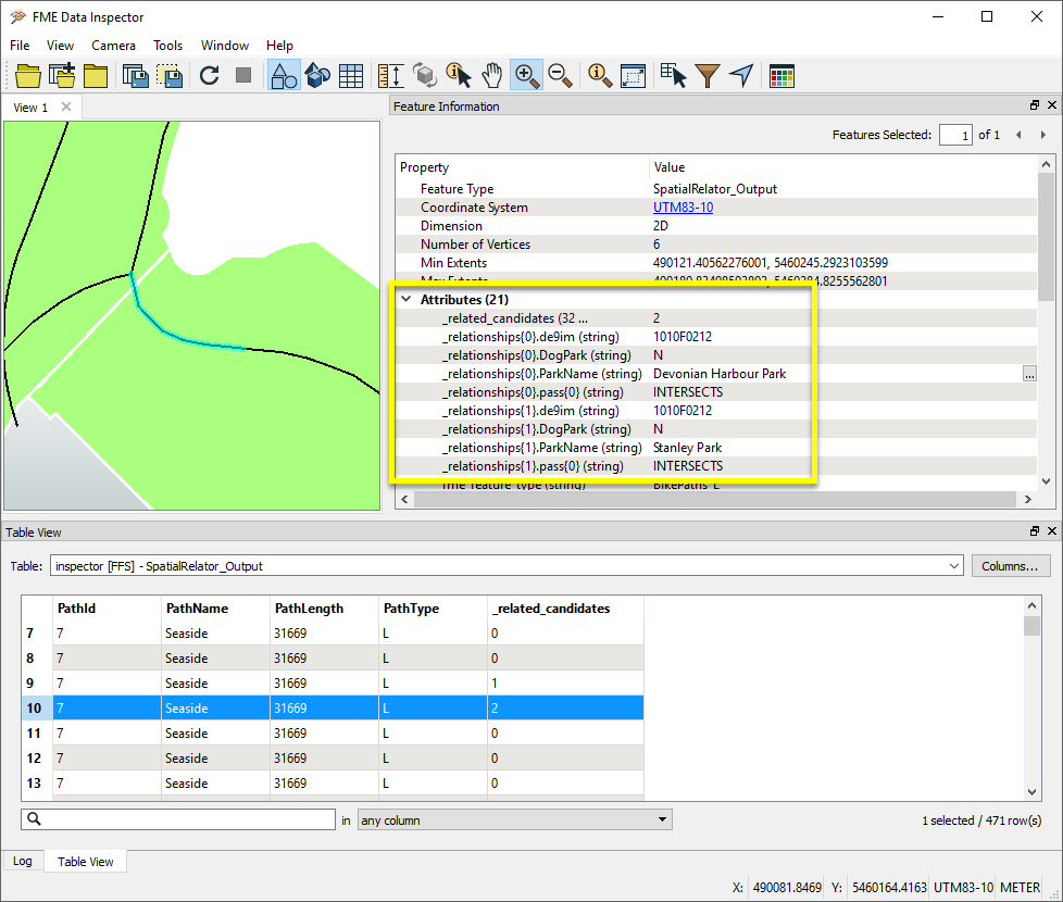

Looking at the results in the FME Data Inspector, with the Parks layer shown for reference, we can see that all of the path segments now have a _related_candidates attribute showing how many park features they matched. Feature 10, highlighted in blue, crosses from one park into another, and so shows two entries for INTERSECTS in its _relationships list attribute.
The geometry of the features has not been altered.
