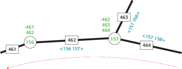

* Red line indicates direction of flow.

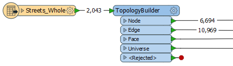

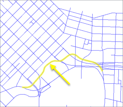

In this example, we start with a set of whole street centerlines, which are not split into individual features at intersections.

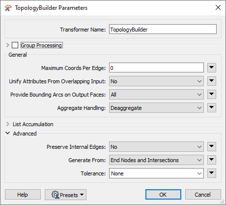

The features are routed into a TopologyBuilder.
The default parameter settings will produce correct and useful results. It is worth noting that the default setting of Generate From is left as End Nodes and Intersections, and so will create intersections where lines cross.

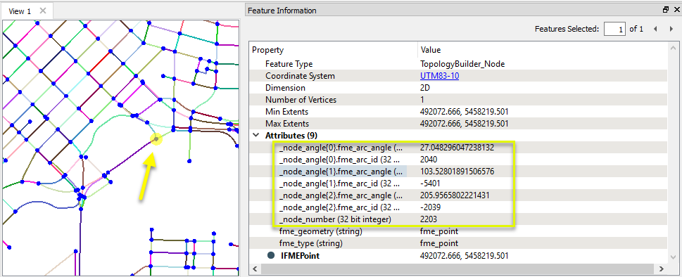

At intersections, the lines are split and nodes are created. Nodes receive attributes about connecting edge (line) features, including identifier and angle.

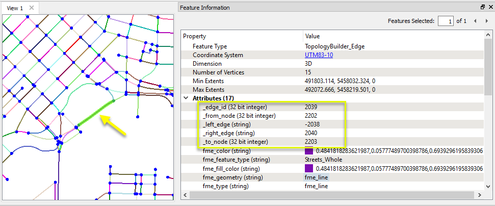

The Edges (line segments) also receive attributes about their relationship with adjacent features.

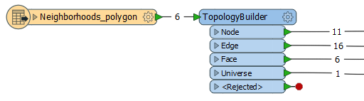

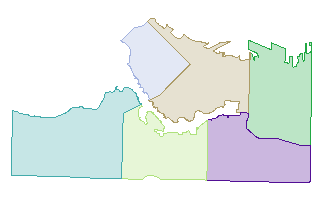

In this example, we compute topology on a set of neighborhood polygons.
The polygons are routed into a TopologyBuilder.

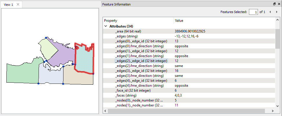

Edges and topologically significant nodes are added, and list attributes created containing topological relationship information, as shown for this selected Face (polygon).

Network Topology in FME
In order to successfully generate a network topology, some conditions must be met.
Lines must touch (be snapped) at an end vertex - first or last.
Lines must be split at junctions. The TopologyBuilder can automate this process, but will not consider z-values (and so may not produce correct results for overpasses/underpasses, for example.)
A junction at an interior vertex (not an end vertex) produces a complex edge, which is not supported.
