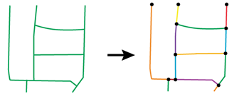

Computes intersections between all input features, breaking lines and polygons wherever an intersection occurs and creating nodes at those locations. Overlapping segments are reduced to one segment before being output.
- Identifying intersections within a dataset
- Reducing geometry to line segments
- Intersecting linear features at junctions to create clean topology
- Cutting overshoots at their intersection
- Creating points (nodes) at intersections to find likely features
The Intersector takes all input features and compares them to each other. Features are split wherever there is an intersection. Split features receive attributes from intersecting features (a spatial join), and the number of overlaps encountered and segments created is counted.
Intersected segments are output, as well as nodes (point features) placed at the location of each intersection. Optionally, a list attribute can be created which will retain attributes for multiple matches.

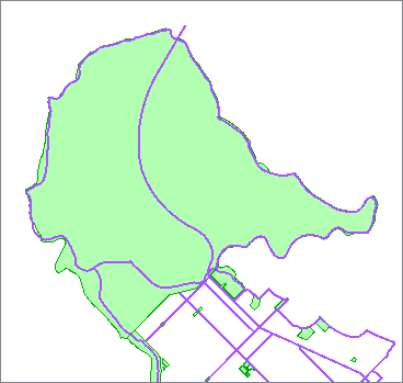

In this example, we start with a set of park polygons and bike path lines, and want to split the polygons where the lines intersect them. To do that, we will first use the Intersector, then build the segmented areas.

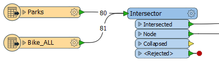

The first step is to route both datasets into one Intersector.
The default settings will produce the results we want.

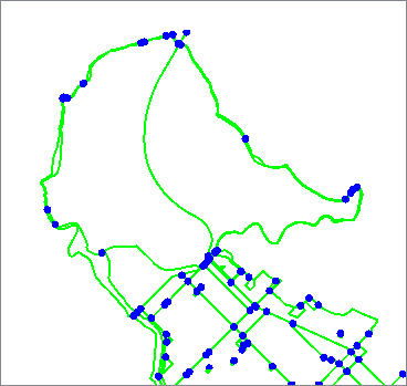

The Intersector reduces all of the geometry to line segments, and creates nodes at the intersection points.

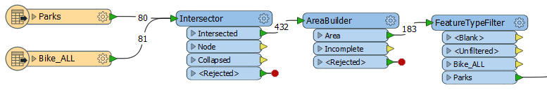

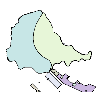

By routing only the Intersected features through an AreaBuilder and then filtering for Parks only, we end up with park polygons, split where the bike paths ran through them.

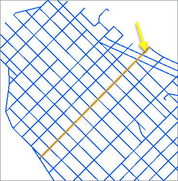

In this example, we start with a dataset of street centerlines. The street geometry is as contiguous as possible - the line segments are not broken at intersections, as shown here with a selected street highlighted in yellow. We want to create intersections, and find out which streets cross at those intersections, using a list attribute.

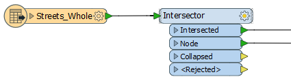

The street dataset set is routed into an Intersector.

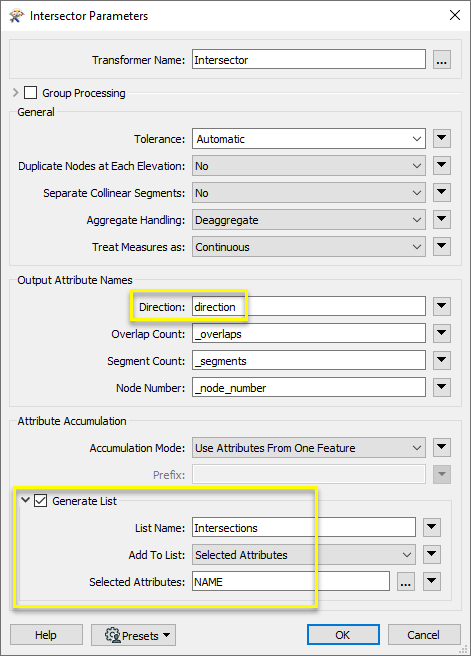

In the Intersector parameters dialog, Generate List is enabled. The list is named Intersections, and one selected attribute - NAME - will be captured in the new list.

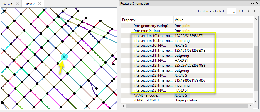

At each intersection of the lines, they are split, and a node is placed at the intersection. The nodes have a list called Intersections, which contains the NAME attribute we requested, as well as the angle and direction of line it is referring to.
The selected node shown here has four items in the list, as four line segments converge at that point - Haro St incoming and outgoing, and Jervis St incoming and outgoing.

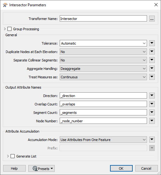

| Group By | The default behavior is to use the entire set of features as the group. This option allows you to select attributes that define which groups to form. |
| Complete Groups |
| Tolerance |
The minimum distance between geometries in 2D before they are considered equal, in ground units. If the tolerance is Automatic, a tolerance will be automatically computed based on the location of the input geometries. Additionally, a custom tolerance may be used. |
| Duplicate Nodes at Each Elevation |
The creation of nodes can be calculated in 3D, if requested. Constructing nodes in 3D would mean that line segments would only share a node if they shared the same Z value at the point they intersected. Constructing nodes in 2D would mean that all intersecting segments would share a common node, regardless of their respective Z values. For example, a situation where two lines (that crossed) represented roads, where one road was an overpass above the other road. with differing elevations. If you constructed nodes in 3D, these two roads would not be linked to the same node where they crossed. Two nodes would be produced at the crossing point – each one with a different Z value. If you constructed nodes in 2D, these lines would both link to a common node, which would be present at the location where they crossed. In either the 2D or 3D case, the full dimensionality of the input is preserved in the output – 3D features are never converted to 2D. The 2D or 3D choice only indicates how the nodes are created and which lines are linked to them; it does not affect the dimension of the features that are output. Yes - Whenever 3D lines intersect at differing heights, two 2D nodes will be output via the Node port. Each node will have the same x and y coordinates, but a different node number. No - Whenever 3D lines intersect at differing heights, a single 2D node is output at the intersection point. |
| Separate Collinear Segments |
If Yes - causes overlapping segments not to be merged into a single segment: one copy is output for each original feature sharing the segment. Each such segment will have the respective original feature’s attributes as its main attributes, and attributes from all other collinear features will be added as a list attribute, if the list name was supplied. When a coverage of polygons is input, the set of topologically significant lines which form their boundaries is output. |
| Aggregate Handling |
Deaggregate: All input aggregates will be deaggregated, and each split part will be processed independently. With this setting, the transformer might output more features than were given as inputs. Reject: All input aggregates will be rejected. |
| Treat Measures as |
When new coordinates are added due to intersection, the measures at those coordinates are determined from existing coordinates. Continuous: New measures will be computed from a linear interpolation of the neighboring coordinates along that segment. Discrete: Measures will be set to the measures of the nearest coordinates along the intersected segment. |
Direction |
Name this optional attribute to include in generated lists. On segment features, it indicates whether the attributes at that entry in the list come from a collinear feature that had the "same" or "opposite" direction as the output feature. On node features, it indicates whether the attributes at that entry in the list come from a segment feature that is "outgoing" from the node or "incoming" to the node. |
| Overlap Count |
Name the attribute to contain the number of collinear input lines that overlapped the output segment. |
| Segment Count |
Name the attribute to contain the number of segments into which the segment’s original feature was divided. If an input feature was broken into n output segments, each of those segments will have an attribute named <attribute name> which has a value of n. |
| Node Number |
Name the attribute to contain a unique ID for each topologically significant node. |
| Accumulation Mode |
Specifies how attributes should be accumulated. Drop Attributes: All incoming attributes are removed from the features. Merge Attributes: Merges all attributes from overlapping segments. Use Attributes From One Feature: Takes all attributes from one representative feature. |
| Prefix | When Separate Collinear Segments is Yes, and Accumulation Mode is Merge Attributes, this value prefixes all incoming attributes on collinear segments. It does not affect node (point) output. |
Generate List
When enabled, adds a list attribute to the output features, and the attributes of intersecting features are added to the list. Nodes will receive list attributes from all intersecting features, including direction and angle.
| List Name |
Enter a name for the list attribute. Note: List attributes are not accessible from the output schema in FME Workbench unless they are first processed using a transformer that operates on them, such as ListExploder or ListConcatenator. Alternatively, AttributeExposer can be used. |
| Add To List |
| Selected Attributes | Enabled when Add To List is set to Selected Attributes. Specify the attributes you wish to be included. |
