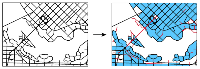

The example below illustrates a set of topologically connected linework on the left and the output of the AreaBuilder transformer on the right. In the output, the topologically correct polygons are highlighted in blue where the linework formed closed shapes, while the lines that did not close are shown in red.
