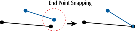

The example below illustrates end points of two line features snapping together.

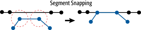

The example below illustrates vertices of a segment snapping to another segment.
