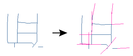

Creates two-point extensions to linear features that extend the feature by a user-specified length.
This transformer can also output the original feature with the first and last segments stretched by a user-specified amount. Each of the created features gets a copy of all attributes of the original feature, including the feature type.
Arcs that are input are converted to lines before processing, and extension lines are placed tangent to the arc.
This transformer can create an extension of the first segment in the input feature. This feature's orientation is the same as the first segment of the input feature and its end point is the same as the input feature's start point. This new feature is output to the Beginning port.
This transformer can create an extension of the last segment of the input feature. This feature's orientation is the same as the last segment of the input feature and its start point is the same as the input feature's end point. The feature holding this segment is output to the End port.
This transformer can create a duplicate of the input feature except that the first and last segments are extended in their respective orientation directions. The length of these extensions is also controlled by the Extension Length parameter. In this case, the end nodes of the line are moved; no new nodes are added. The feature holding this segment is output via the Stretched port.
