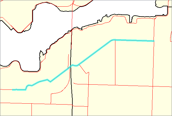

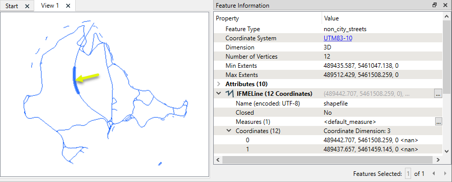

In this example, we perform an overlay of bike path lines on neighborhood polygons. The source data looks like this, where the highlighted blue line is a bike path line feature that crosses from one neighborhood to another.
We want to accomplish two tasks in this example:

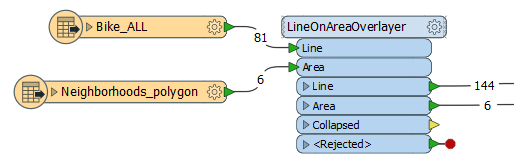

In the workspace, the bike paths are connected to the Line input port, and the neighborhoods are connected to the Area input port.

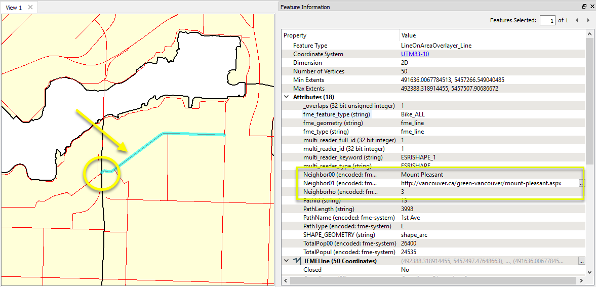

Viewing the output, we can see that the selected bike path (in blue) has been split where it crosses the neighborhood boundary, and the neighborhood attributes for Mount Pleasant have been added to it.
The containing neighborhood encountered 18 overlaps, and now has a list attribute containing the bike path names.

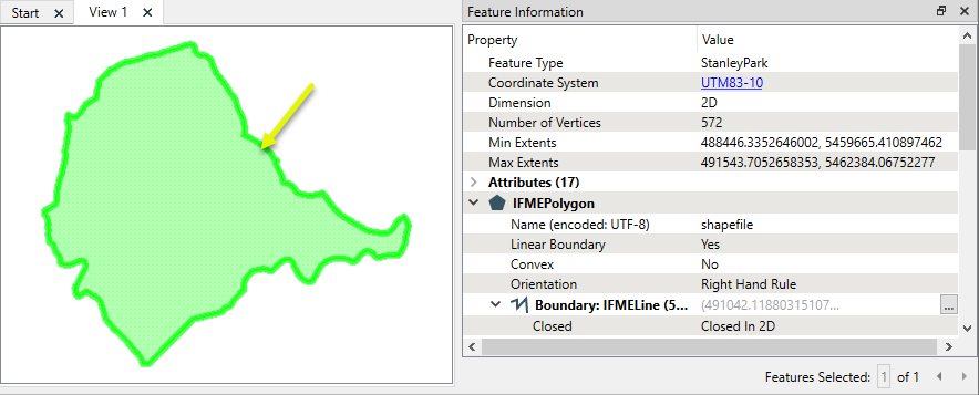

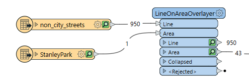

In this example, we have a single polygon covering the extent of Stanley Park.
The park is crossed by numerous roads and pathways, and we want to divide the park polygon into pieces based on these lines.
Both the park and the roads are routed into a LineOnAreaOverlayer.

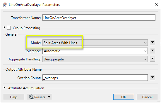

In the parameters dialog, Mode is set to Split Areas With Lines.
The lines are output unchanged, and the park polygon has been subdivided into smaller areas where the roads and paths cross it.
