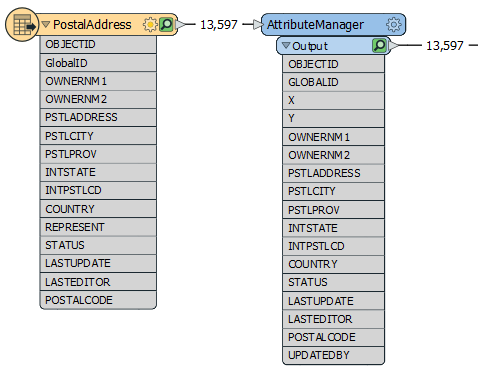

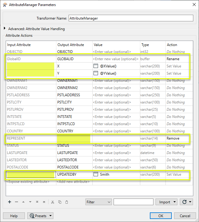

In this example, several attributes of the input features are modified:
- GlobalID is renamed, changing the case of the attribute name.
- An unwanted attribute, REPRESENT, is removed.
- X and Y attributes are created and values are assigned by extracting geometry with an FME function
- UPDATEDBY is created and set to the fixed value Smith.
- All other attributes pass through untouched.
The altered attributes are reflected in the transformer.

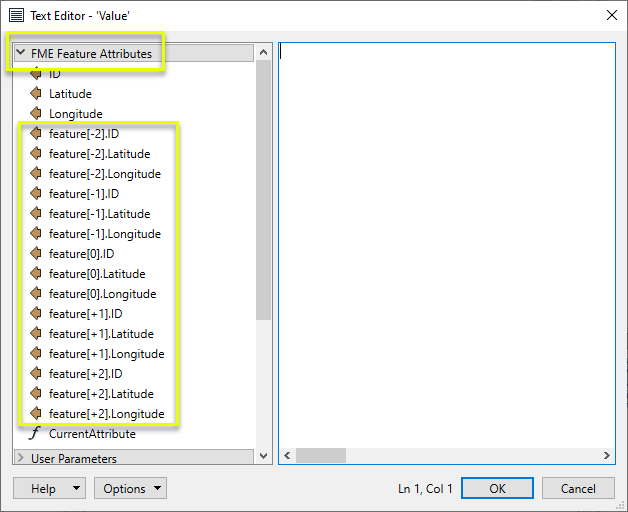

Calculations referencing adjacent features can be created in the Arithmetic Editor and the Text Editor. These editors will list the attributes of the currently processed feature first, then the prior features, then the subsequent features.
