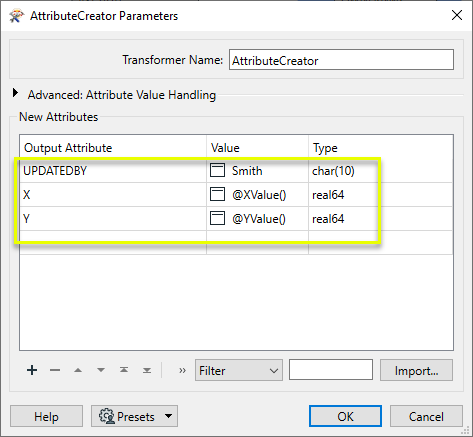

- In this example, three new attributes are added to the input features:
- UPDATEDBY is added and set to the constant value “Smith”.
- X and Y are added, and set to the feature’s coordinates by extracting geometry with an FME function.

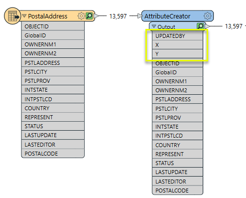

The new attributes are reflected in the transformer, at the top of the attribute list.

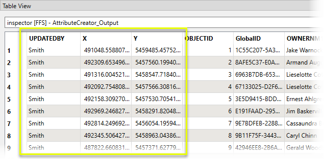

The attribute values are updated, and can be viewed in the FME Data Inspector’s table view.

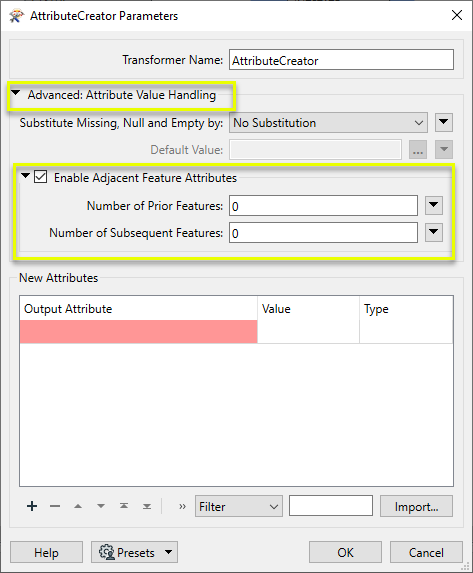

Adjacent Feature Attributes are accessed under Advanced: Attribute Value Handling. When turned on, you can specify a number of features preceding and following the current feature to reference in calculating new values.

Enable Adjacent Feature Attributes
When enabled, you may set an attribute value (in the Attribute Actions table) based on the attributes of features prior or subsequent to the current feature by referencing them as follows:
- Attributes of prior features are referenced as feature[-1].AttrName, feature[-2].AttrName, and so forth.
- Attributes of subsequent features are referenced as feature[+1].AttrName, feature[+2].AttrName, and so forth.
- Attributes of the currently processed feature are accessed directly without a prefix, such as AttrName.
When retrieving the value of a prior feature, any changes made by the AttributeManager to that feature will take effect.
Number of Prior Features |
This parameter specifies the maximum number of prior features that can be referenced by the AttributeManager. If Multiple Feature Attribute Support is enabled, this must be a value from 0 to 100. As additional features must be read for each feature processed, defining only the maximum number of features needed to be retrieved will improve performance. |
Number of Subsequent Features |
This parameter specifies the maximum number of subsequent features that can be referenced by the AttributeManager. If Multiple Feature Attribute Support is enabled, this must be a value from 0 to 100. As additional features must be read for each feature processed, defining only the maximum number of features needed to be retrieved will improve performance. |
When an AttributeCreator is opened for the first time, this area will contain a blank row where a new attribute can be created. Additional rows are added as entries are made.
| Output Attribute |
Enter the name of the new attribute. Names may also be assigned using expressions or the context menu to retrieve existing attribute values, User Parameters, or assign conditional values. |
| Value |
New attributes can be left without a value for use elsewhere, or you can set new values here by clicking in the appropriate row and:
See Defining Values below for detailed information on using these options. |
Type |
Specify the attribute's data type. The ellipses button will open an Attribute Type Definition dialog, which can assist with setting Type, Width, and Precision (where necessary). Note that compatibility between Value and Type is not enforced here. See also: FME Data Types. |
