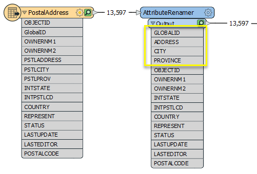

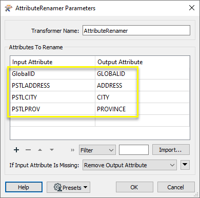

In this example, we have a geodatabase of postal addresses. We want to alter some of the attribute names, and so the features are routed into an AttributeRenamer.
In the parameters dialog, several attributes are renamed at once. GlobalID undergoes a case change to become GLOBALID, and three more attributes are renamed.
The changes are reflected in the transformer - note that the renamed attributes appear first.

When an AttributeRenamer is opened for the first time, this area will contain a blank row where you can select or enter an attribute to be renamed. Additional rows are added as entries are made.
Input Attribute |
Enter or select the name of an existing attribute from one of the drop-downs. |
Output Attribute |
Enter a new name for the attribute. |
Default Value |
Enabled when If Input Attribute is Missing is set to Set Default Value. The value to set the Output Attribute to if the Input Attribute does not exist on the feature (a default value). If the Default Value is blank, and the Input Attribute does not exist on the feature, the Output Attribute will not be created. See Defining Values for various methods of setting these. |
If Input Attribute is Missing |
Select an action to take if a specified input attribute has no value: - Remove Output Attribute - Preserve Existing Output Attribute - Set Default Value - enables the Default Value column |
