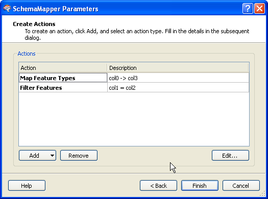

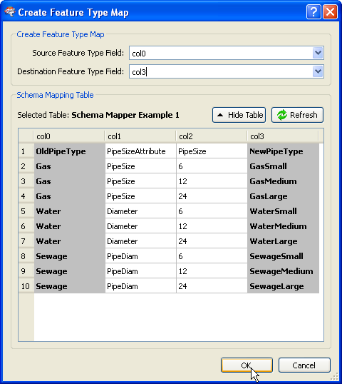

- On the Create Actions pane, click Add and select the action type. For this example, we'll select Feature Type Map.
- Select the Source and Destination Feature Type Fields. You can show/hide the table columns, and refresh the contents.
- Click OK to return to the Create Actions pane, which now shows the Feature Type Map action you just set.
Note: To transform your source schema to a new schema, you can create more than one action depending on the mapping rules that you want to apply to the existing schema.
- To add another action, select from the Add drop-down menu. In this example, we'll select Filter to display the Create Filter dialog:
- Select the table columns in the Attribute Name and Value Fields. By default, Blank Attribute Values are ignored but you can choose to include them.
- Click OK to return to the Create Actions dialog. The Action column now shows two actions: Map Feature Types and Filter Features:
- Click Finish to set the SchemaMapper parameters.
