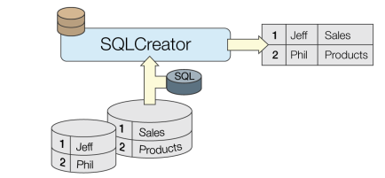

The SQLCreator executes a SQL statement against a database. It has no input ports, and so (unlike the SQLExecutor) is not reliant on incoming features to trigger the statement - rather, the query is run one time only.
SQL statements are constructed within the transformer, using the appropriate syntax for the database in use. Spatial queries are supported if the database supports spatial predicates.
One feature is output for each row of the query results, via the Result port.
A single schema feature may also be produced if supported by the database.

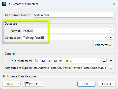

A SQLCreator is placed in the workspace.
In the parameters dialog, the Database Connection is selected (or defined, if not previously saved).

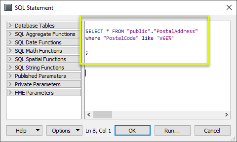

A SQL statement is constructed in the SQL Statement parameter, using the built-in editor. The syntax matches the database being used.
There is a convenient shortcut in the editor - by right-clicking on a table (or column) name under Database Tables, you can create a quick statement based on SELECT and more to start editing from.
In this case, we are selecting all of the records in the PostalAddress table that have a postal code starting with V6E.

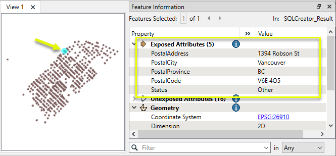

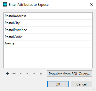

By default, the output has hidden attributes. Choose the ones you wish to include in the Attributes to Expose parameter.
The query results are extracted, including geometry.
