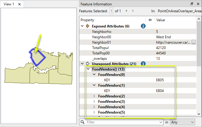

In this example, we have a set of polygons representing neighborhoods. They have a list attribute - FoodVendors{} - that contains unique IDs (KEY) for the food trucks located in the area. The task is to merge additional attributes for each vendor from a spreadsheet.

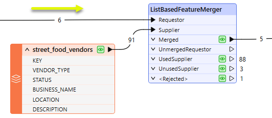

In this portion of a workspace, the area (with list) features are routed into the Requestor port of a ListBasedFeatureMerger. The spreadsheet is attached to the Supplier port.

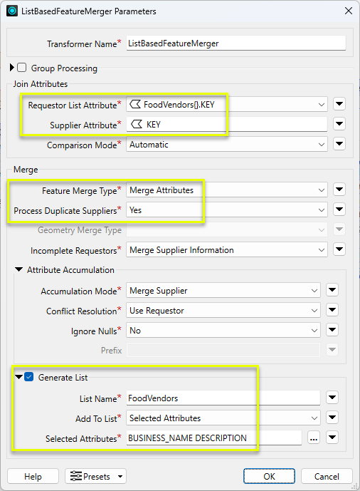

In the parameters dialog, the Join Attributes are set to match the FoodVendors{}.KEY list attribute (Requestor) with the KEY attribute from the spreadsheet (Supplier).
In Merge Parameters, we choose to merge Merge Attributes, and (importantly) to Process Duplicate Suppliers. This will ensure that all food vendors in the list are matched, not just the first one encountered.
And finally, we enable Generate List, to create new list attributes on the output features. It will contain all matching Business names and descriptions, via Selected Attributes. Note the list name entered - FoodVendors - is the same as the existing list name. This will result in the new attributes being added to (and expanding) the current list. If we entered a different name here, a new list attribute would be created.

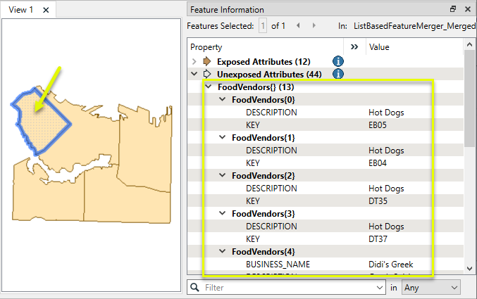

Inspecting the features output from the Merged port, we see that additional attributes have been added to the FoodVendors{} list and can now be used elsewhere in the workspace.
