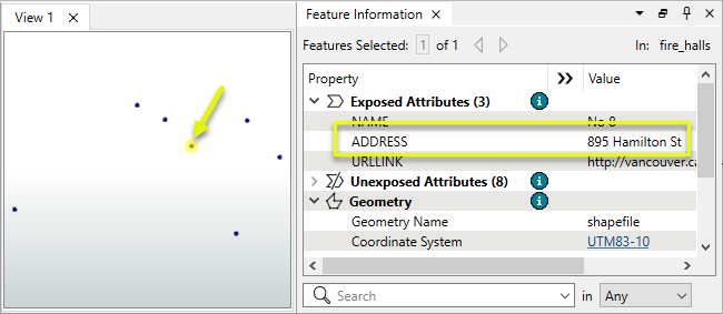

In this example, we have a dataset of fire halls, which includes point geometry and some attributes. They have a street address, but not a complete postal address.

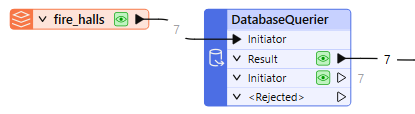

The fire_halls dataset is connected to the Initiator port on a DatabaseQuerier. Each fire_halls feature will cause the query to be executed, for that feature.

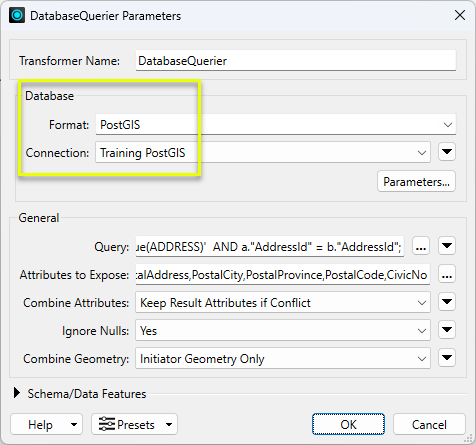

The first step is to connect to the external database. Select the Format, in this case, PostGIS. Then configure (or select, if pre-saved) the database Connection.

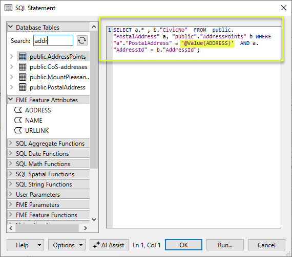

Next we create a query to join both tables. Note:
- @value(ADDRESS) is providing a value from the Initiator feature - the address for a specific feature, which restricts the results to only matching records for that feature. Since the query is run every time a feature passes through, this repeats for every fire_halls feature.
- The PostalAddress table is being joined to the feature using PostalAddress field.
- The AddressPoints table (which contains the CivicNo attribute) is joined to the PostalAddress table (not the Initiator feature), using a different key - AddressId.

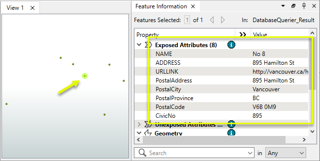

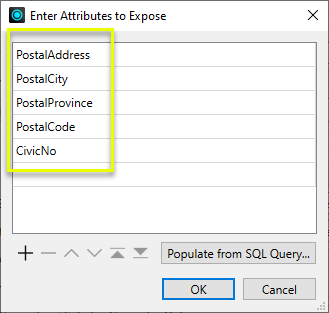

As the attributes will be hidden by default, we choose a set of attributes to expose on our output features.
The features with query results are output via the Result port, and have new attributes added by the query.
