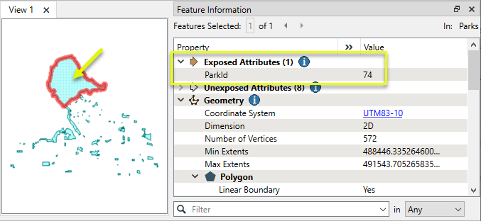

In this example, we want to retrieve attributes from a table in a PostGIS database, and add those attributes to park polygons stored in a shapefile. The parks have an ID number which will be used to do the joining.
The features are routed into a DatabaseJoiner, where we will retrieve the rest of the attributes we want.

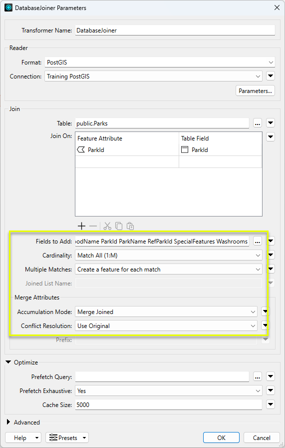

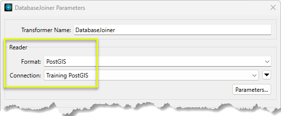

In the parameters dialog, the first step is to define the external database - much like configuring a regular database format reader.

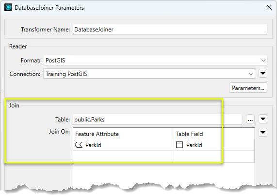

With the database connection made, we now select the desired table (public.Parks) via the browse button next to Table. This will load a list of available table to choose from. We then choose the attribute from both the incoming parks (Feature Attribute) and joined table (Table Field) to join on. In both cases, the attribute is called ParkId.

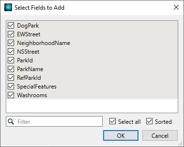

Fields to Add determines which attributes from the external database table are added to the Park features. We Select All of them.
The default values for Cardinality, Multiple Matches, and attribute merging will provide the results we want.

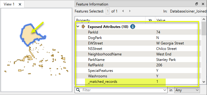

The output features from the Joined port now have additional attributes that were retrieved from the external database table. Note that the _matched_records attribute shows how many matches were encountered - in the case, one.
