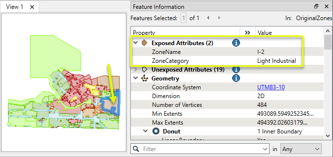

In this example, we have two copies of a zoning dataset. One of them has been updated, with changes made to some zone attributes. The polygons do not have a unique ID that could be used to do a comparison to find the updated zones, so we need to use geometry matching.

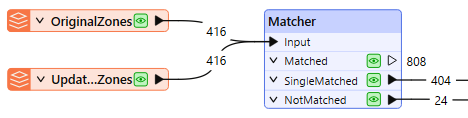

Both the original and updated datasets are routed into a Matcher.

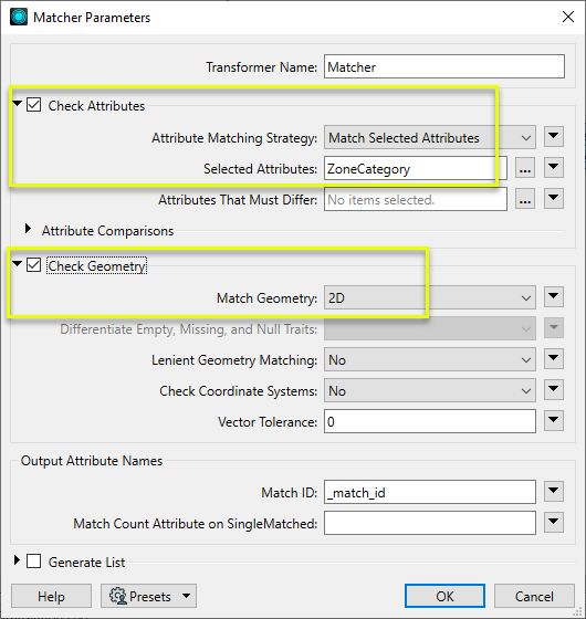

Match Geometry is set to 2D, and the Attribute Matching Strategy is Match Selected Attributes. We select ZoneCategory as the attribute to compare. This will find polygons that have matching geometry, and check whether or not the attribute has been changed.

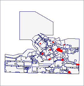

One copy of the polygons that matched are output via the SingleMatched output port. These are the records that were not altered, shown below in blue.
Records that were altered would not encounter a match - though the geometry is the same, the attribute we specified is not. These features are output via the NotMatched port, shown here in red.
