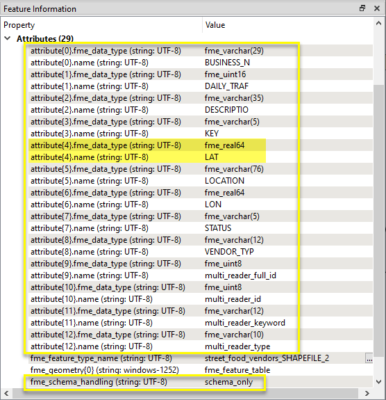

Schema features can be used to store or pass along schema structures - to dynamic writers, for example. The schema is stored in a list attribute named attribute, as shown here.
Each attribute has a name and an fme_data_type - note the attribute LAT has a corresponding data type of fme_real64.

One or more Schema Features - depending on whether Group Processing is enabled. Each schema feature has a list attribute in the form:
attribute{}.name
attribute{}.fme_data_type
One element for every attribute in the input data features.
The transformer adds a special attribute and value:
fme_schema_handling = ‘schema_only’
