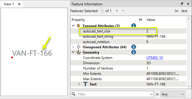

In this example, we have a CAD file containing traffic signal locations and labels. The original file is projected as UTM83-10, but we want to know what will happen to the label height if we reproject to BCPOLY-83.
Note that the label's autocad_text_size value is 2.

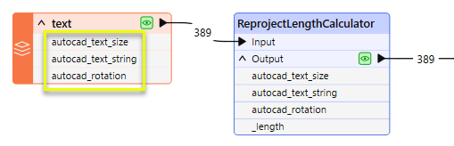

The features are routed into a ReprojectLengthCalculator.
Note that three format-specific attributes have been exposed - autocad_text_size, autocad_text_string, and autocad_rotation. This was done in the Autodesk AutoCAD DWG/DXF Reader parameters, Format Attributes, so that we can access their values.

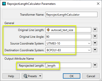

In the parameters dialog, we set Original Line Length to the exposed autocad_text_size attribute, and Original Line Angle to 90 degrees (pointing north).
Both the Source and Destination Coordinate Systems are specified explicitly.
The Reprojected Length attribute is named _length (default).

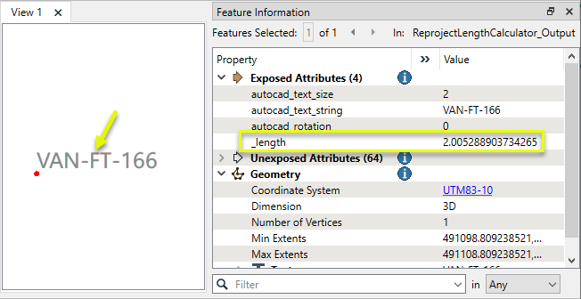

The output feature has a new attribute - _length - containing the value of the reprojected line length.
Note that the Coordinate System has not changed and is still UTM83-10. The feature itself has not been reprojected, its geometry not altered. The reprojection to BCPOLY-83 has only been used to calculate the _length value.
