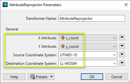

In the parameters dialog, the x and y attributes containing the coordinates are specified accordingly, the source coordinate system entered (as UTM83-10), and the new destination coordinate system chosen (LL-WGS84).
The new coordinates are calculated and replace the existing attribute values. The transformer does not create geometry, it only supplies values.

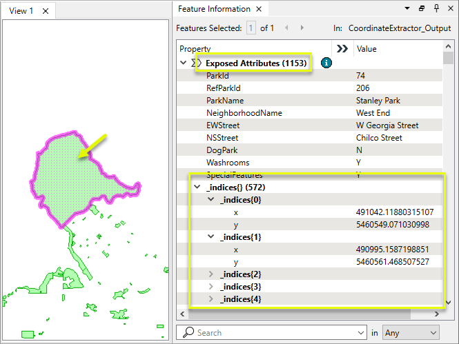

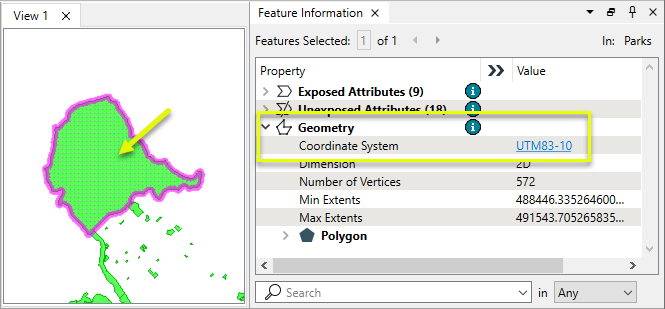

In this example, we have a set of park polygons, in a UTM coordinate system. We want to generate coordinates in an alternate coordinate system and keep them on the park polygons as an attribute.

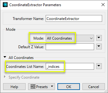

To do this, we will use a CoordinateExtractor to extract the polygon vertices into a list attribute, and then reproject that list with an AttributeReprojector.
In the parameters dialog of the CoordinateExtractor, note that All Coordinates will be stored in a list attribute named _indices.
Polygons output from the CoordinateExtractor have a list attribute containing their coordinates. Note that each list item has an individual x and y coordinate.

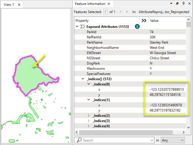

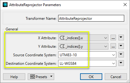

In the parameters dialog of the AttributeReprojector, X and Y Attribute are set to the corresponding list item. The coordinates will be reprojected to LL_WGS84.
The reprojected coordinates have replaced the input list attribute values.
