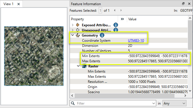

In this example, we have a raster that appears to be in a local coordinate system but has an assigned coordinate system of UTM83-10.
The raster is routed into a CoordinateSystemRemover, which has no parameters to set.
The output feature has its coordinate system removed, but its coordinates are unchanged.
