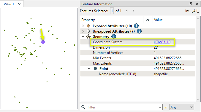

Note that while the coordinate system is known (UTM83-10), it is not accessible as an attribute.

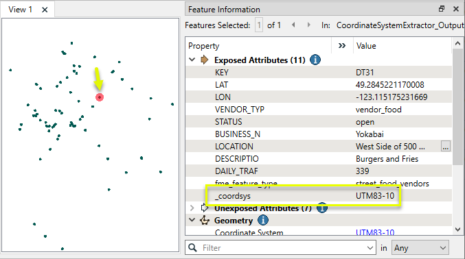

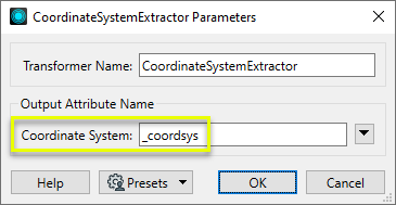

The features are routed first into a CoordinateSystemExtractor, and then on to a CoordinateSystemDescriptionConverter.
In the parameters dialog of the CoordinateSystemExtractor, the default name for the new attribute to contain the coordinate system information is _coordsys.
Using the FME Data Inspector to examine the features as they exit the transformer, we can see that the FME representation of the coordinate system - UTM83-10 - has been added to the new _coordsys attribute.

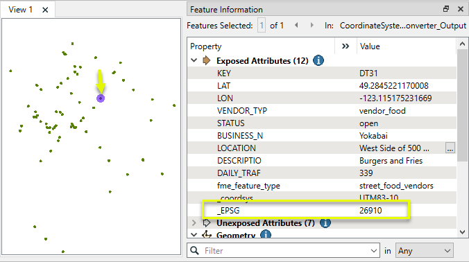

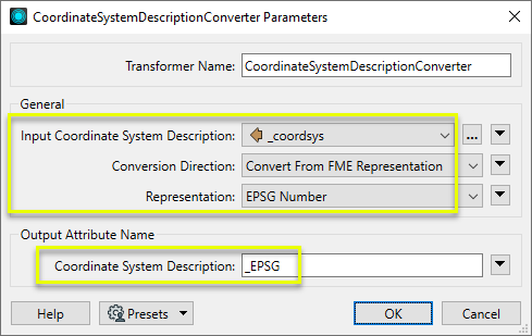

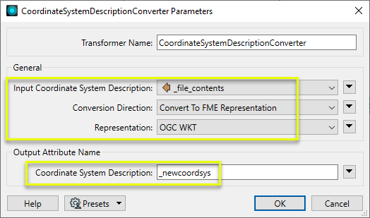

In the parameters dialog of the CoordinateSystemDescriptionConverter, we identify the new _coordsys attribute, choose Convert From FME Representation, select EPSG Number as the destination representation, and edit the new attribute name which will hold the results.
The output features have a new attribute, _EPSG, containing the EPSG number.

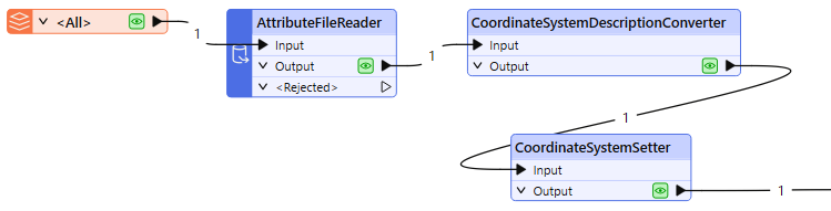

Using the coordinate system will take three steps.

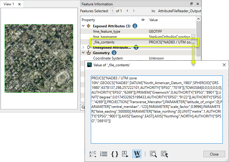

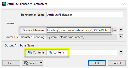

First, the raster is routed into an AttributeFileReader, and the text file is read. Its contents, the definition string, are added to the new attribute _file_contents.
Examining the feature as it exits the AttributeFileReader, it has a new attribute containing the OGC WKT string.
Because we cannot apply a WKT coordinate system directly, we need to convert that definition to one that FME will understand.

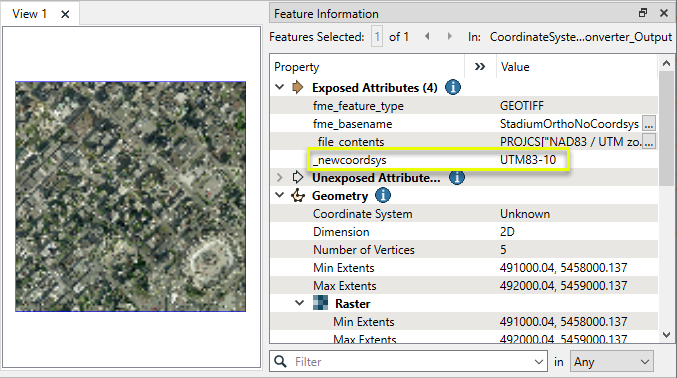

The feature is sent to a CoordinateSystemDescriptionConverter. In the parameters dialog,we set the source to the newly added _file_contents attribute, Convert To FME Representation, choose OGC WKT, and keep the default new attribute name of _newcoordsys.

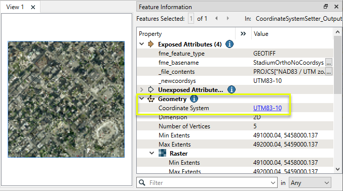

Examining the feature as it leaves the transformer, we can see that it still does not know its coordinate system, but we do have the FME name of it in the _newcoordsys attribute.

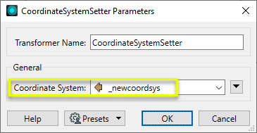

The final step is to use a CoordinateSystemSetter to apply the coordinate system. In the parameters dialog, we set Coordinate System to the recently added attribute _newcoordsys.
The final output feature now knows its coordinate system.
