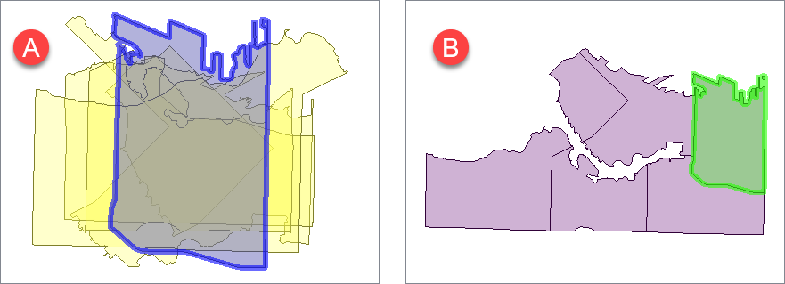

The Reprojector can also reproject features to local coordinate systems, however, each feature is handled individually and receives its own coordinate system based on its bounding box. An example using neighborhood polygons is shown below (A). Each feature’s origin is at its center, and so they appear stacked on top of each other.
The CommonLocalReprojector creates a single local coordinate system that spans all of the input features, and applies it to all of them (B).

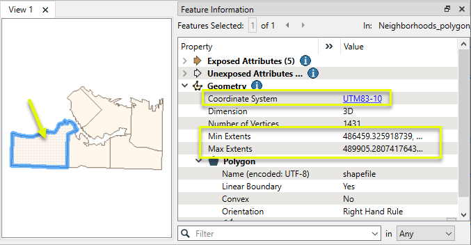

In this example, we have a set of neighborhood polygons, in a UTM coordinate system. Note that the extents are appropriate coordinates.
We want to reproject these polygons to a single common local coordinate system.

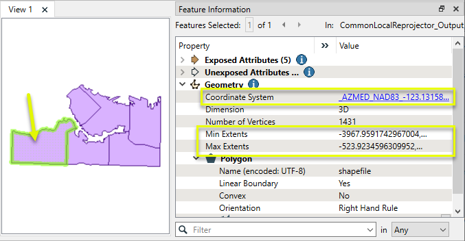

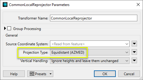

In the parameters dialog, we set Projection Type to Equidistant (AZMED) .
The features are output to a local coordinate system based on the bounding box of all input features.
