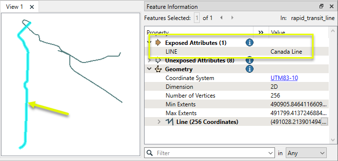

In this example, we have a set of rapid transit lines and want to generate the bounding box that contains all features.
Note that they have an attribute containing the name of the line.

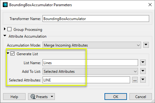

In the parameters dialog, we enable Generate List to add a list attribute to the output bounding box. It is named Lines and will contain the LINE value from all input features.

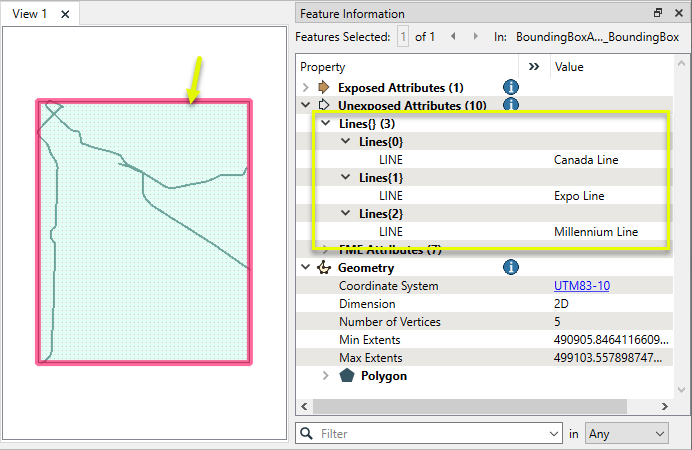

One bounding box is produced, spanning all input features. Note the list attribute containing the LINE values.
