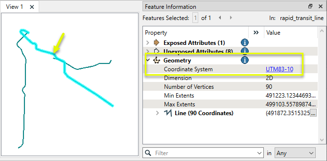

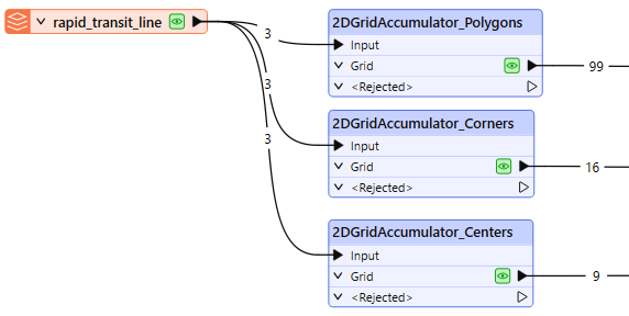

In this example, we have a set of transit lines, and want to create a variety of grids over the extents of the dataset.
Note that the features have a UTM coordinate system, with ground units in meters.
The features are routed into multiple 2DGridAccumulators.

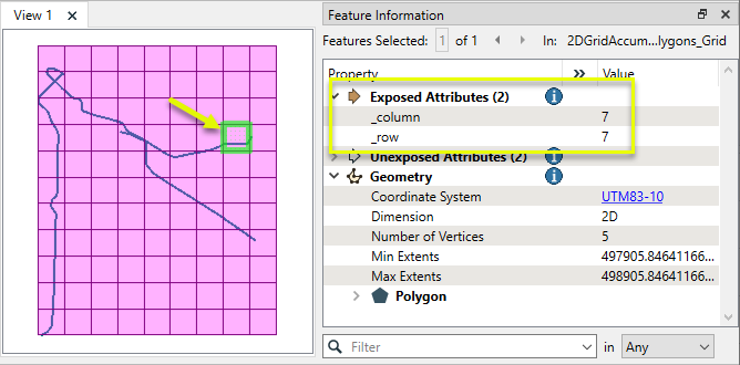

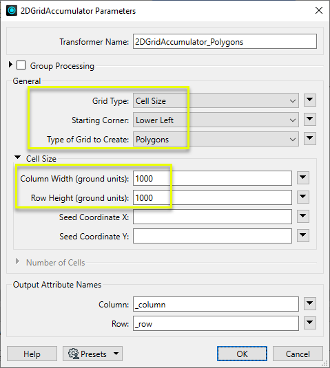

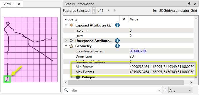

Rectangular Grid
In the first parameters dialog, Grid Type is set to Cell Size, with size set to 1000 meters square. Type of Grid to Create is Polygons.
The resulting grid covers slightly more than the data extents - a result of the fixed cell size, starting from the lower left corner.
The polygons have received a new attribute containing their column and row numbers.

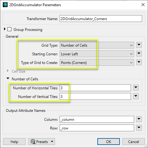

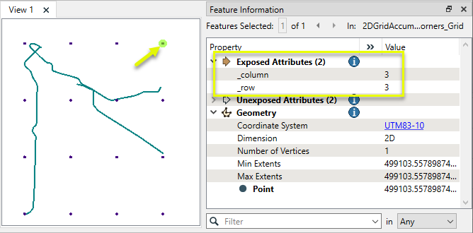

Grid Points
Dividing the extents into equal parts, Grid Type is set to Number of Cells and a 3 x 3 grid is requested.
Type of Grid to Create is Points (Corners).
Points are placed at the calculated cell corners.
Note that the Starting Corner was Lower Left, which becomes column 0, row 0. The grid does not extend past the features, as the cell size was calculated by dividing those extents into equal cells.

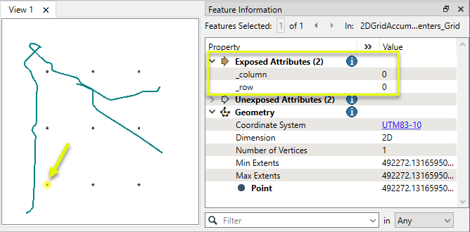

With Type of Grid to Create set to Points (Centers), each cell is represented by its center point. The Starting Corner cell (in this case, lower left) is column 0, row 0.

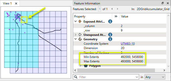

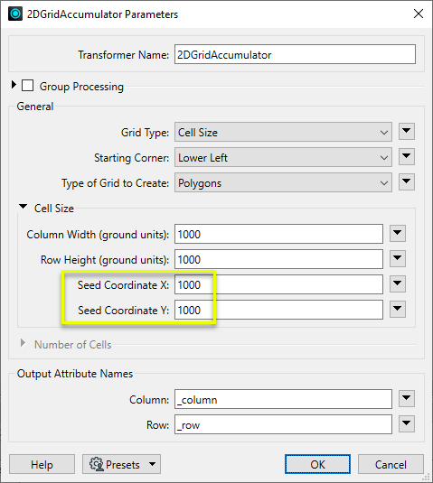

In this example, we will use seed values to refine the rectangular grid from the previous example, creating a grid that can be replicated and aligned with other generated grids.
Note that the grid cells are 1000 by 1000 meters, starting in the lower left corner.
As they are positioned relative to the extents of the underlying features, the cells would not necessarily line up with another 1000 by 1000 meter grid generated for a different feature set in the same area.
In the parameters dialog, we set both Seed Coordinate X and Y to 1000.
The resulting grid has cells placed predictably, falling every 1000 meters both horizontally and vertically.
Using the same seed values and cell size on another dataset produces a grid that aligns with this one.
