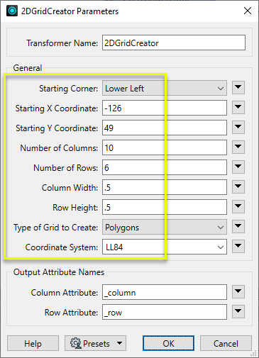

In this example, we will generate a grid along lines of latitude and longitude.
A 2DGridCreator is added to a workspace.
In the parameters dialog, we specify cell size, position, grid extent, and coordinate system. Type of Grid to Create is Polygons.

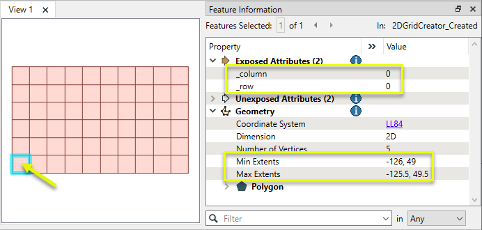

A grid of rectangular polygons is produced.
Note that the cells are numbered from the selected Starting Corner (Lower Left), starting at 0,0.

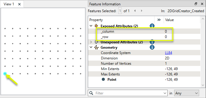

If Type of Grid to Create is Points (Corners), point features are placed at all cell corners.

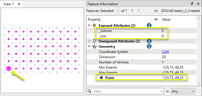

Points (Centers) places a single point at the center of each cell, as shown here in conjunction with the Points (Corners) grid.
