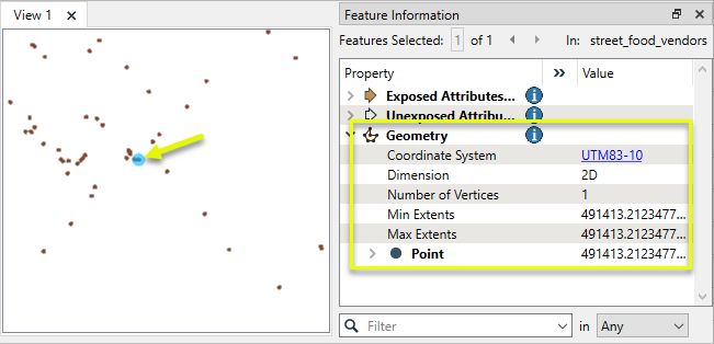

In this example, we have a point dataset of food cart vendors. We want to replace the points with boxes centered on the point locations.
Note that the features have a UTM coordinate system, with ground units in meters.
The features are routed into a 2DBoxReplacer.

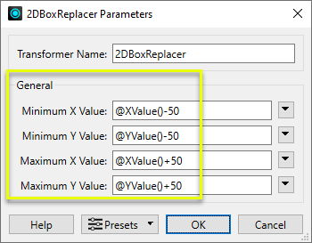

In the parameters dialog, expressions are created to offset the corners by 50 meters from the point location.

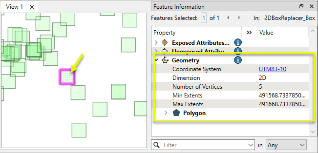

The points have been replaced with boxes.
