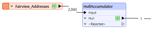

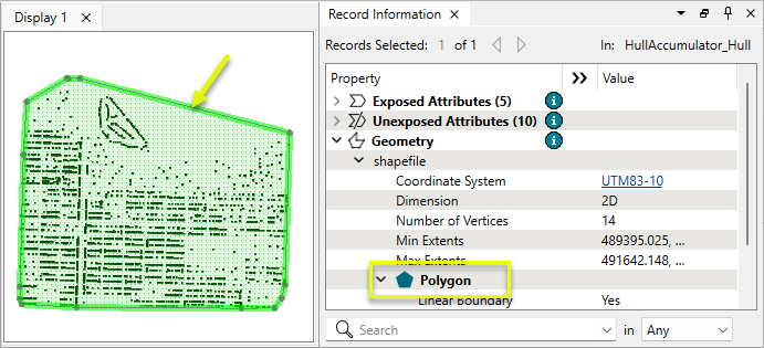

In this example, we have a set of address points and want to generate a convex hull around them.
The features are routed into a HullAccumulator.

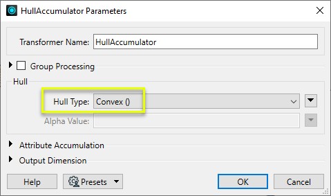

In the parameters dialog, Hull Type is Convex ().
The output hull contains all input features.
