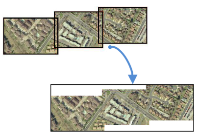

Merges multiple raster features into a single raster feature.
- Merging multiple rasters
- Joining abutting raster tiles together into a single feature
- Merging overlapping raster features together, blending the overlaps
- Preparing data for use in operations that require a single raster feature (eg VectorOnRasterOverlayer)
The RasterMosaicker accepts a number of raster features and combines them into a single raster feature.
The input rasters must all have the same number of bands and palettes, or selected bands and palettes.
Each band is individually mosaicked together, and then appended to the output raster. The output raster will have the same number of bands and palettes as the input (whether whole rasters or selected bands/palettes).
If there are gaps in data (that is, areas not covered by any raster), the empty cells will be filled with Nodata values if available, or zero if not.

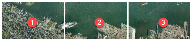

In this example, we start with a set of three individual georeferenced images.

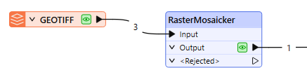

The features are routed into a RasterMosaicker.

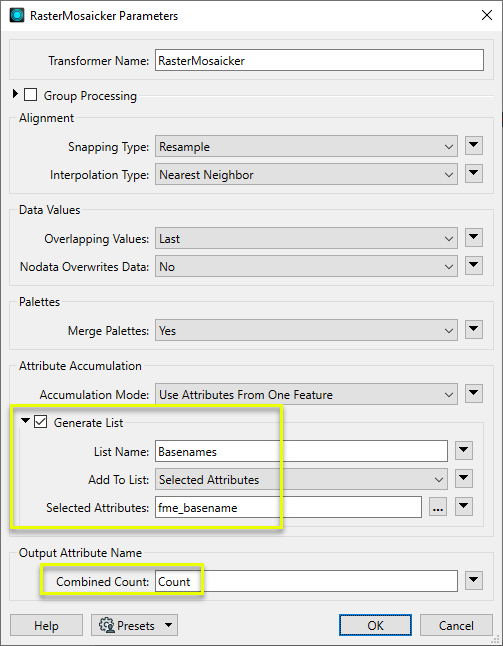

The default settings will provide the desired results. We will also add a Combined Count attribute - Count - to track how many images have gone into the mosaicked image, and create a list attribute called Basenames which will contain the name of each source image.

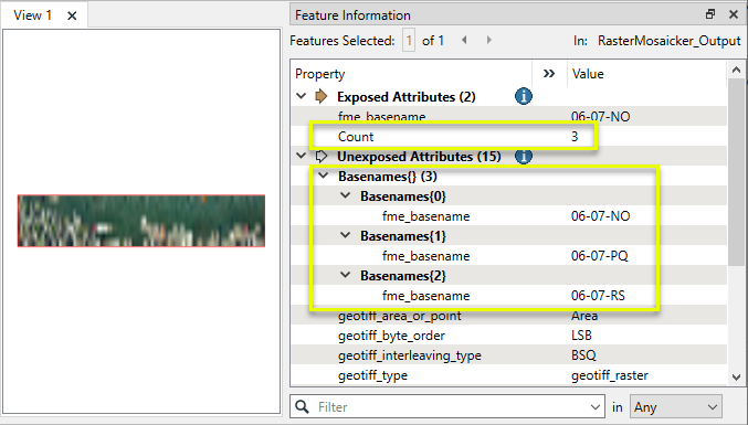

One single raster feature is output. In the FME Data Inspector, we can see the new list attribute and count, indicating that three rasters went into the mosaic, and what their names were.
