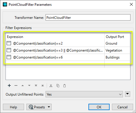

In this example, will filter a point cloud by using its classification values. Note that the source dataset is urban, with a mix of structures, roads, buildings, and vegetation.

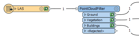

The point cloud is routed into a PointCloudFilter.
In the parameters dialog, we create three expressions based on the classification component values.
Note that the Vegetation expression is more complex, looking for any one of three possible values (|| means “OR”).

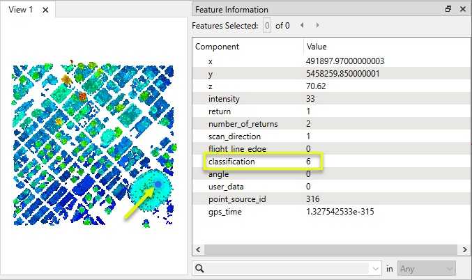

Examining the output of the Buildings expression in the FME Data Inspector, we can see that this particular output feature contains only the points with a classification value of six, which are the buildings.

For each expression entered in the Expression table, a corresponding Output Port is named and created.
![Closed](../Skins/Default/Stylesheets/Images/transparent.gif)
If Output Unfiltered Points is Yes, points that do not match any of the specified expressions are output via the <Unfiltered> port.

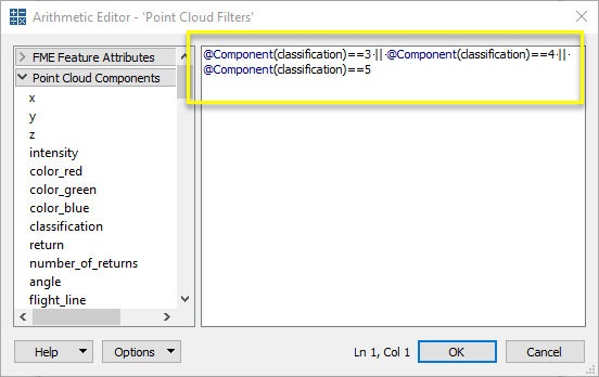

Expression |
Define an expression describing which points to include. The Arithmetic Editor may be accessed via the ellipsis (...) button to assist in creating expressions. |
