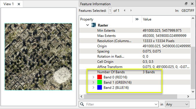

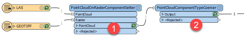

In this example, we will apply color to a point cloud using an orthophoto raster. The raster is RGB48 - that is, each of its color bands are 16 bits.

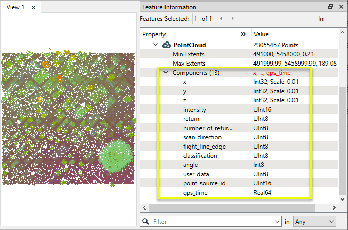

Note that the source point cloud feature does not have color components (colors shown in the FME Data Inspector are simply a representation of elevation - z coordinates).
We want to produce a point cloud with 8-bit color components, and so need two steps.

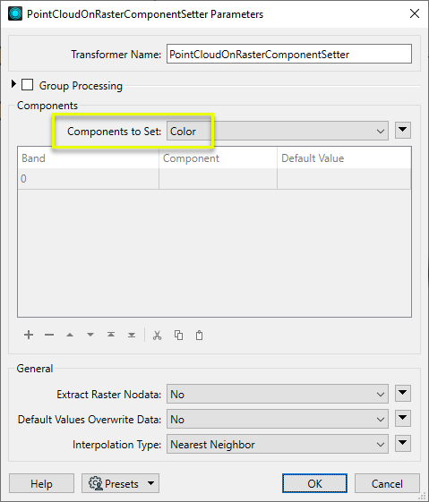

First, both the point cloud feature (LAS) and the raster feature (GEOTIFF) are routed into a PointCloudOnRasterComponentSetter, where colors will be extracted from the orthophoto and applied to the point cloud as components.
Next, the resulting point cloud feature (with 16-bit color components) is sent on to a PointCloudComponentTypeCoercer, where the data type will be changed and the color values scaled accordingly.
Step 1 - Applying Colors
In the parameters dialog of the PointCloudOnRasterComponentSetter, Components to Set is set to Color.

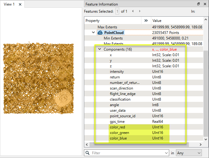

Note that the point cloud feature produced in this first step now has color components, and they are data type UInt16 (unsigned integer, 16-bit).

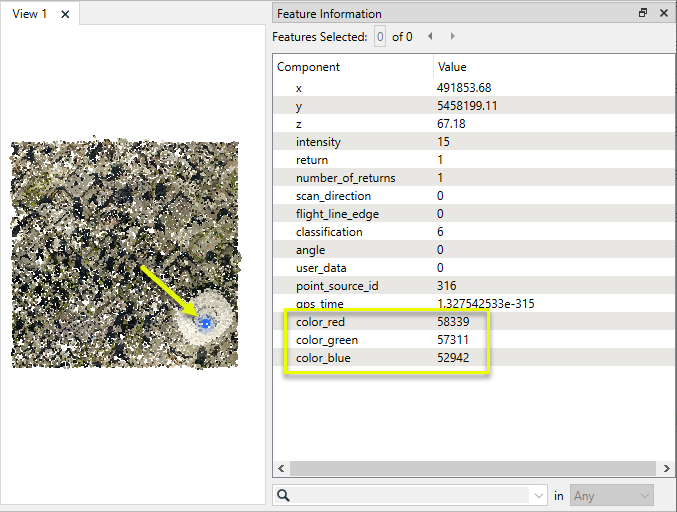

When examining a single point in the point cloud, we can see that the color values fall within the range of 0 to 65535 (the possible values for a 16-bit unsigned integer).

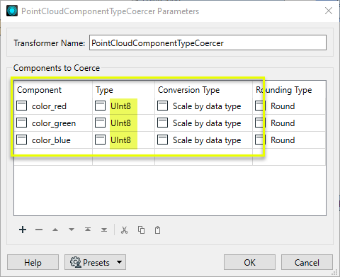

Step 2 - Altering Data Type and Scaling Values
In the parameters dialog of the PointCloudComponentTypeCoercer, all three color components are set to Type UInt8, and the Conversion Type is set to Scale by data type. This will scale the values while preserving their proportions in regard to the original and new types’ ranges.
The output point cloud feature now has 8-bit color components.
Individual points’ color values have been proportionately scaled, and now fall within the range of 1 to 255 - the possible values for an 8-bit unsigned integer.
