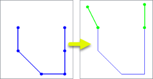

The Chopper receives vector features including lines, arcs, paths, and areas, and breaks them into smaller pieces. Attributes are preserved on all output features.

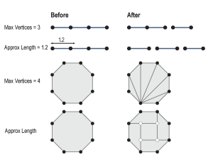

New vertices are not added to the feature. Chopping is done at existing vertices, guided by a choice of Mode:
By Vertex: Features are chopped at the interval specified in Maximum Vertices. Output features with fewer vertices than the maximum are tagged as remnants (generally the last segment).
By Length: An Approximate Length is specified, in ground units. The input features are chopped into segments as close as possible to this length, without adding new vertices. Output feature lengths will vary, depending on the length value and distance between vertices on the feature.
