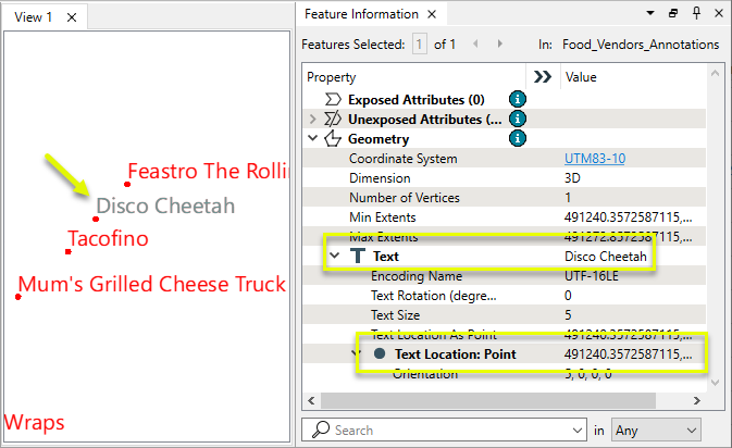

In this example, we have a set of text labels and want to convert them to simple point geometry.
The features are routed into a TextLocationExtractor. There are no parameters to set.

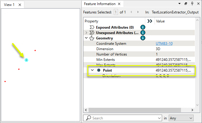

The output features are points, and the text properties have been discarded.

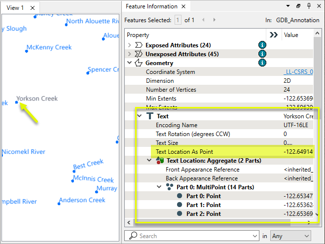

In this example, we have a set of complex annotations that have been retrieved from a geodatabase.
In their source environment, these cartographic labels follow the course of waterways. FME Data Inspector (and most formats) cannot render that detail, so the labels are displayed as normal text.
Note that in addition to the Text Location as Point coordinates, the selected feature also has aggregate multipoint geometry stored.

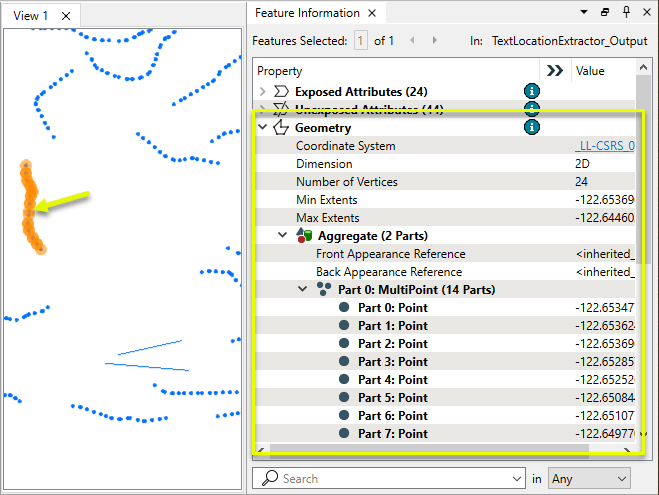

The text is replaced with geometry representing the original annotation, which can be further manipulated.
