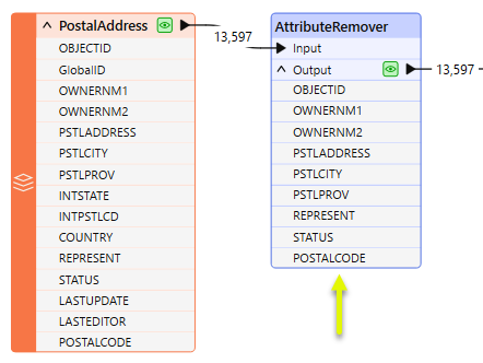

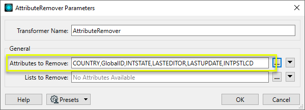

In this example, several attributes are selected from the pick list for removal.
The Attributes to Remove parameter is populated with those choices.
As the features exit the transformer, the selected attributes have been removed:

Attributes to Remove |
Click the browse button to display the list dialog. Select the attributes that you want to remove from the feature. The unchecked attributes will be retained. |
