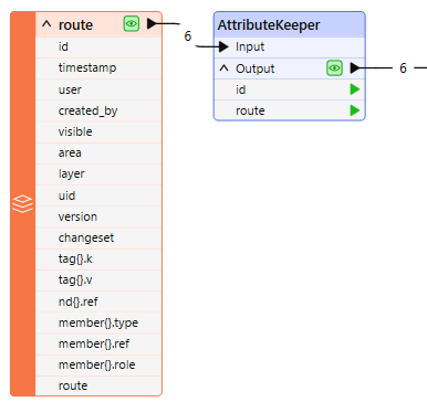

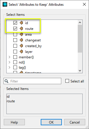

In this example, two attributes are selected from the pick list to keep.

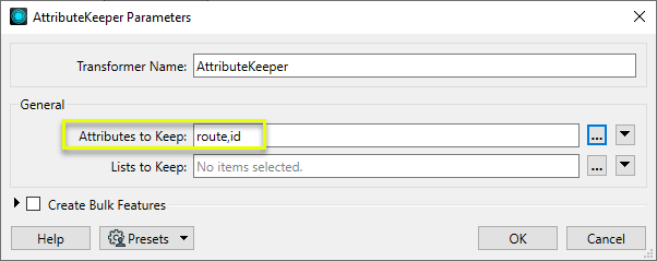

The Attributes to Keep parameter is populated with those choices.
As the features exit the transformer, all of the unwanted attributes have been removed, including all lists:

Attributes to Keep |
After the AttributeKeeper is connected, click the browse button to display the list dialog. Select the attributes that you want to keep on the feature. The unchecked attributes will be removed, except for any FME attributes. Format attributes will be removed, whether exposed or not. |
Lists to Keep |
After you connect the transformer, click the browse button and select the lists to keep. Note that if you select to keep a list, your selection will include any list attributes or nested lists. For example, if you select to keep a list called list{} then list{}.attr or list{}.sublist{} will also be kept. The Lists to Keep parameter is a way to keep an entire FME list (for example member{}.type). To keep specific list elements (for example member{0}.type) select them under Attributes to Keep. |
