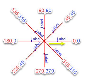

Label Orientation
The orientation of the text varies according to the orientation of the line segment it is placed on. Text is placed parallel to the line segment.
If the line angle produces text that is upside-down (that is, between 90 and 270 degrees), the text is rotated 180 degrees.
Both the line and text angles may be added as an output attribute.
