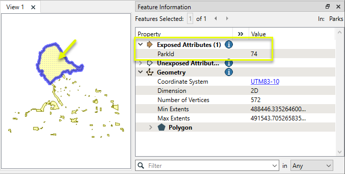

In this example, we will use an InlineQuerier to perform a SQL join between Park polygons in a shapefile and attributes in a CSV text file. Both sets of features have a common key - the ParkId attribute.

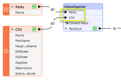

When the InlineQuerier is first placed in the workspace, it has no Input or Output ports.
After adding both dataset readers, we connect each one to Connect Input. Table definitions and Input ports are created.

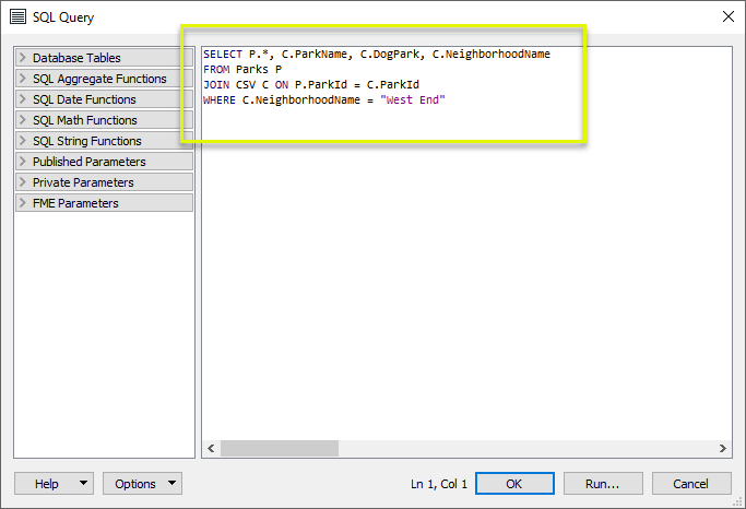

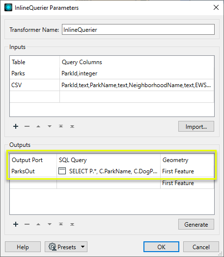

In the parameters dialog, we add an Output Port called ParksOut, and construct a SQL query that will provide the features to be output.

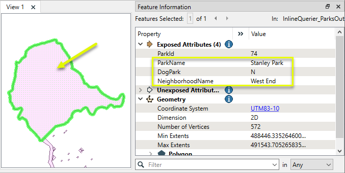

This query joins the CSV features to Parks via their common key, and selects three new attributes to be added to the Park features (ParkName, DogPark, and NeighborhoodName). As well, only parks in the West End neighborhood will be output.
For each Park feature, the query is executed and new attributes attached. The features are output via the ParksOut port we defined, associated with the SQL query.

The InlineQuerier requires definition of one or more Tables, which will become input ports to the transformer.
The simplest way to define a table is to connect features to the Connect Input port.
The Import… button will add a definition from the source feature types in the workspace.
You may also manually define Tables and Columns.
