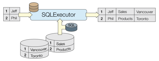

The SQLExecutor executes a SQL query against an external database.
SQL statements are constructed within the transformer, using the appropriate syntax for the database in use. Spatial queries are supported if the database supports spatial predicates.
Schemas may also be produced if supported by the database.

This transformer has two modes, depending on whether a connector is attached to the Input port or not:
- Input-driven: When input features are connected, the transformer runs once for each feature it receives in the Input port.
- Run Once: When no input features are connected, the transformer runs one time and outputs a single new feature.

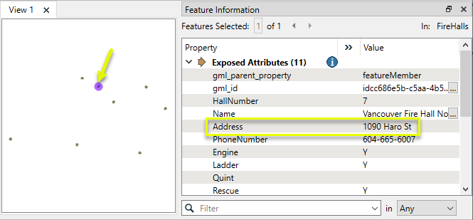

In this example, we have a dataset of Fire Halls, which includes point geometry and some attributes. They have a street address, but not a complete postal address.
We will use a SQLExecutor to join a database table (using the Address field as a key), and retrieve the complete postal address.

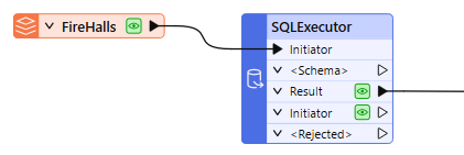

The FireHalls datasets is connected to the Initiator port on a SQLExecutor. Each FireHalls feature will cause the SQL query to be executed, for that feature.

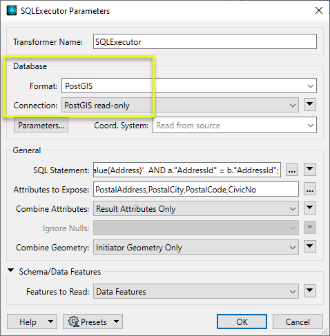

The first step is to connect to the external database. Select the type, in this case, PostGIS. Then configure (or select, if pre-saved) the database Connection.

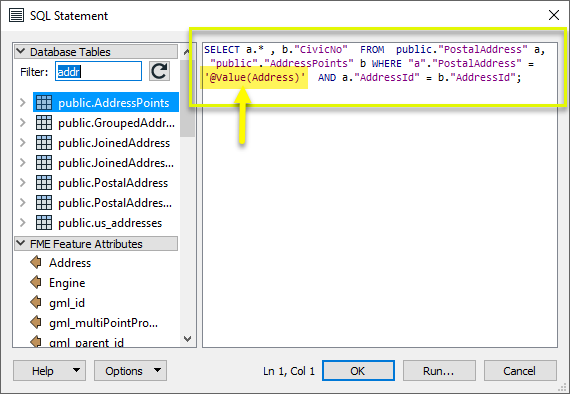

Next we create a SQL statement to join both table. Note:
- @value(Address) is providing a value from the Initiator feature - the address for a specific feature, which restricts the results to only matching records for that feature. Since the query is run every time a feature passes through, this repeats for every FireHalls feature.
- The PostalAddress table is being joined to the feature using PostalAddress field.
- The AddressPoints table (which contains the CivicNo attribute) is joined to the PostalAddress table (not the Initiator feature), using a different key - AddressId.

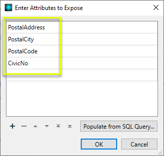

As the attributes will be hidden by default, we choose a set of attributes to expose on our output features.

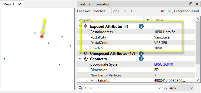

The features with query results are output via the Results port, and have new attributes added by the SQL statement.
