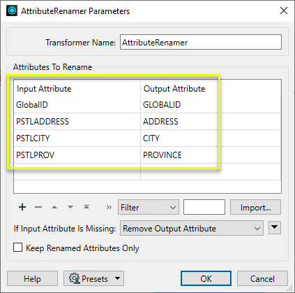

In this example, we have a geodatabase of postal addresses. We want to alter some of the attribute names, and so the features are routed into an AttributeRenamer.
In the parameters dialog, several attributes are renamed at once. GlobalID undergoes a case change to become GLOBALID, and three more attributes are renamed.

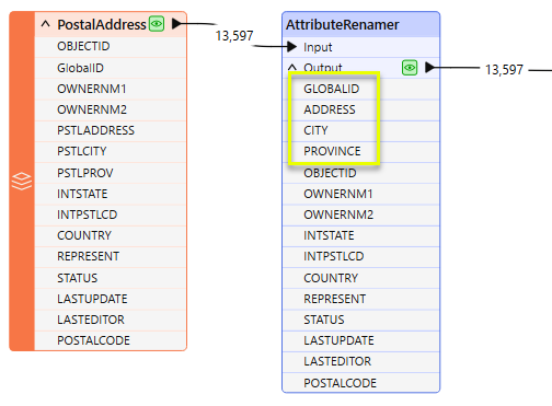

The changes are reflected in the transformer - note that the renamed attributes appear first.
